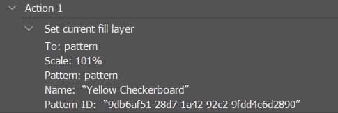

It could also be for just a pattern fill layer, it doesn't have to be a layer style...
Again, the problem with actions is the scale is a set value that will be a constant. And I need to the scale to change between each PSD since it's a different value.

Are all you patterns created form the same size canvas  and have design that have object with similar number of pixels.   If your patters do not have the same Aspect Ration  no mater what percent scale you set the the patterns will tile differently.
A script cans get a layers bounds to the know a layers location and a get the document bounds and document print resolution with ease.  With Action manager code a  script can mostly likely get the size of a pattern.  With this information you may be able to calculate some scale percentage  for the pattern to fill the layer so the Paters scaled the way you want it scaled for a particulate document canvas size and print resolution.
JJMack
Aug 15, 2021 Aug 15, 2021
All of the patterns have the same aspect ratio and pixel sizing.The only difference between the patterns is in colour.
When you change a patterns fill in Photoshop by clicking another pattern, all it does is change the 'Name' and 'ID' variables and doesn't touch the scale. This is exactly what I want the script to do since the action is incapable of this.

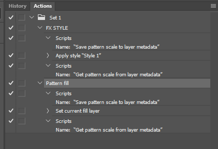

LEGEND ,
To Apply Style 'Style 1', you choose it from Styles panel? Then on your screenshot you Set Current Fill Layer, but to do it first it's needed to make Adjustement Pattern Layer?
Mentor ,
Yes. It is assumed that the user does not create, but changes the pattern. That is, all the necessary layers have already been created and configured. At least that's how I understood @32621919
LEGEND ,
After actions are created and I want to use them again, what am I supposed to do?
(there is metadata in a layer, but after playing actions I don't see much difference)
Mentor ,
I don’t know what patterns you used when checking, perhaps their initial scale was close to each other. Try to manually set the scale value like 500% before save it in metadata
LEGEND ,
Aug 17, 2021 Aug 17, 2021
So you use later only last 'get' script action item for another patterns. That I needed to know.

I'm going to read over your script and try it out. Thank you for sharing.
Aug 16, 2021 Aug 16, 2021
After trying out the scripts and action you gave me, it works perfectly. Thank you for this, it's saved a huge amount of time.
