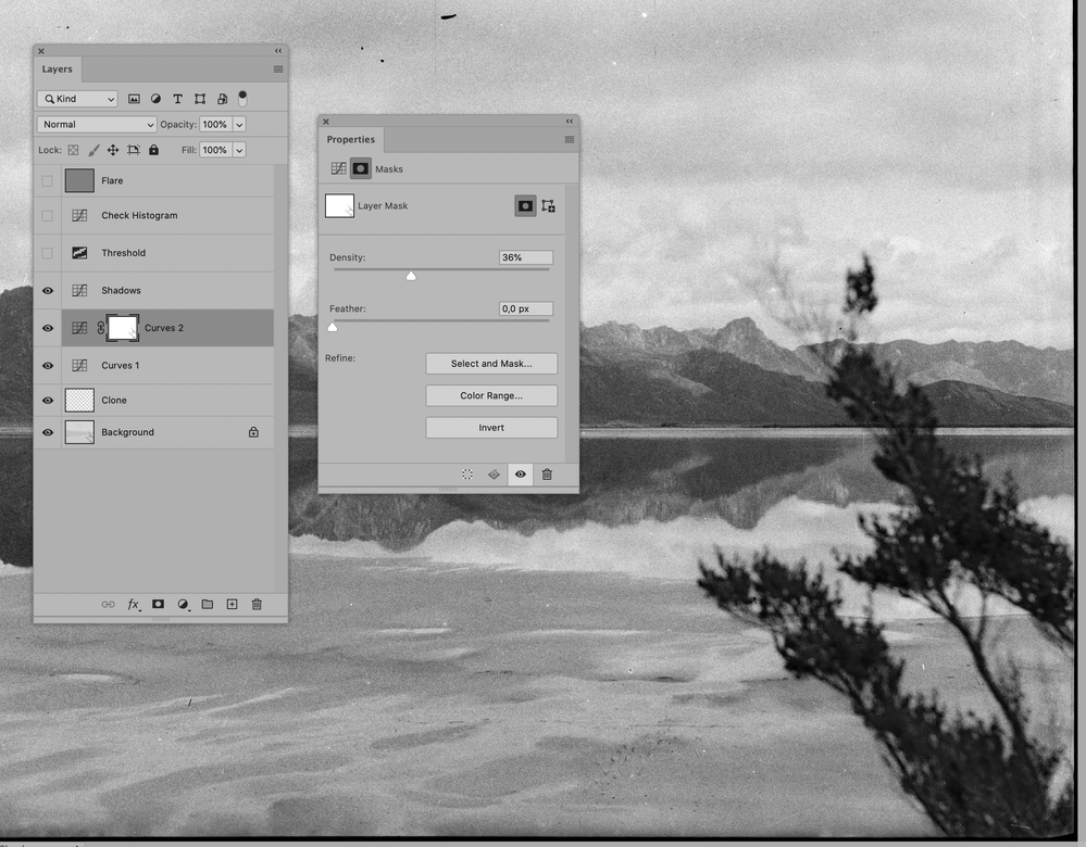

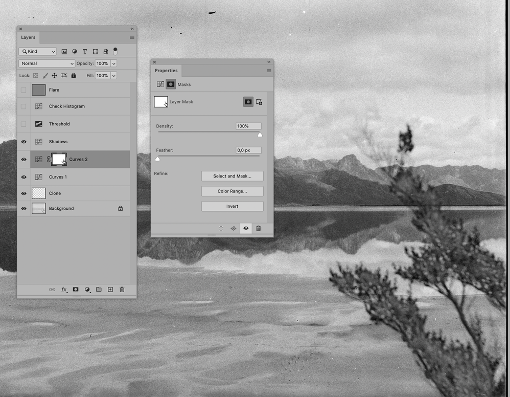

Anyway here are screenshots to illustrate the Density.
The Properties Panel can also be used to edit a Mask’s Feather.
