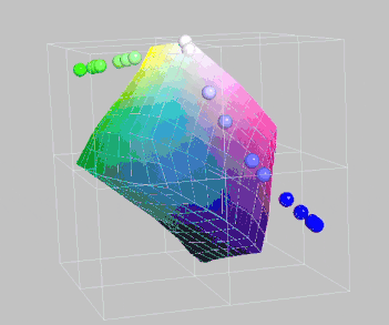

One reason the cartridges can’t make some colors is that cyan, magenta, yellow, and black inks simply can’t be as saturated as an RGB pixel. Another reason is that all inks have some impurities which prevent them from achieving their best theoretical saturations. A third reason is that print media is reflective, so it’s naturally limited to the light hitting it. If the light is not bright or not pure white, there is no way the ink can match a highly saturated RGB value coming off of a screen with an intense light source of its own (emitted, not merely reflected). Paper is not a light source like a computer display, so paper can never match a screen in brightness.
Below is an illustration of the problem. The solid volume in the middle is a 3D representation of the color gamut of Canon Pixma printer inks on Red River Arctic Polar Gloss paper. (Because the exact color gamut depends on the specific combination of inks and paper used, and pro glossy photo papers tend to have a wider color gamut.)
The dots represent the two RGB colors you specified: 39FF14 and 0000FF (assuming sRGB, because the exact color those values produce depends on the RGB color space). I’m guessing the lighter dots might be aliasing in the image where I drew the colors. You can clearly see that the dots are well outside the volume. That means those colors are too far outside the color range that the printer’s inks can reproduce on that high quality paper. It cannot be done.
If this was going to be printed on a commercial printing press (the kind that can cost $1 million), the printing company might offer you the option to add more process color inks to extend the color range, or add two custom-mixed spot color inks (for example, Pantone inks) that are a closer match to your two colors…all at additional cost, of course. But those options are not available on the kinds of inkjet printers we can carry home for under $250. Even if you spent ten times that much money on a pro inkjet printer with extended gamut inks, it would still not be able to reproduce those colors. Print designers are also aware that CMYK is particularly weak in reproducing highly saturated blues.
The color limitations of different media are so immovable that being able to work within those limitations and find color palettes that hold up across TV/video displays, papers, packaging, signage, etc. is a valuable skill for a designer. So is studying and understanding principles of color theory and human color perception; for example, to make a color appear more saturated, one option is to surround it with a complementary color to make the viewer’s eye perceive that color as more saturated than the inks can actually achieve.

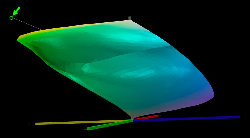

Tell you what; provide a Photoshop doc with the green and blue color made there, in whatever color space you're using. Upload a small, 300x300 pixel image to something like Dropbox.
Then provide as well, the ICC printer profile for your Canon Pixma iX6820 you wish to use. I'll plot the color gamut of that image onto that of the printer. Then we'll know what is or isn't possible using actual colorimetry.
Author “Color Management for Photographers" & "Photoshop CC Color Management/pluralsight"
Aug 25, 2022 Aug 25, 2022
And if you do that, you’ll be the third person in this thread to post a plot of the color value against an inkjet printer’s CMYK gamut, so chances are you’ll the the third person in the thread to show that the printer cannot exactly reproduce #39FF14 (assuming sRGB).
Also, since the claim is that it “prints perfectly in Word,” it may not be possible to use a printer profile in that workflow. It’s probably a black-box driver workflow (send it a default Word RGB print stream, and see what the printer driver puts on the page).
Conrad. I'm not assuming sRGB. I'm not assuming any output profile which is why I asked the OP specifically for his/hers. I hate to assume and try never to do so (but I am imperfect). The other three answers are very, very likely to be correct. If I get the OP's image and profile, I will not have to provide the data back based on any assumptions. It will be perfectly colorimetrically proven (to me). To the OP?
