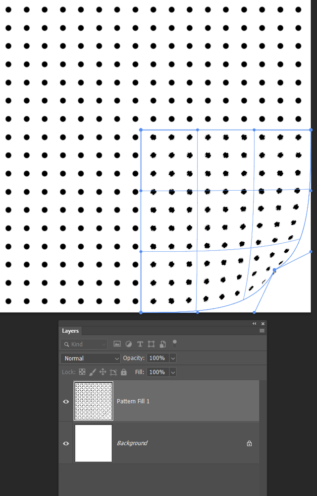

Here's a way you can do it: Add a new layer, and add a #7f7f7f to #ffff gradient from top to bottom in that layer. Enter Quickmask mode, drag a black to white gradient (black where you want the distortion), exit Quickmask, and fill the resulting selection with #7f7f7f. The result shoud be gray with one white corner. Save this as a .psd with Maximize File Compatibility enabled. Hide that gradient layer, and go to the image. Filter > Distort > Displace, with Horizontal Scale set to 0%, and Vertical Scale set to a high value, and choose your saved .psd as the source.
[EDIT] Here's the same done on a grid, to show the actual transform:

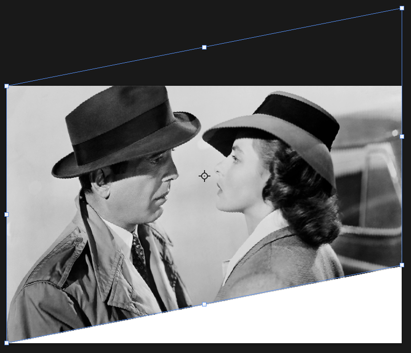

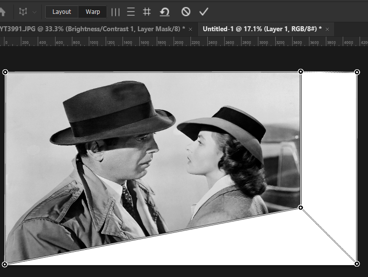

OK, I'm with you now. It's not especially easy to find suitable search phrase, but I think it comes down to that aweful Transform Perspective stretch. I would dearly like to know how to avoid that stretch, or at least control how much it distorts. I've spent some time searching Google with 'Photoshop Transform Perspective without stretching the image'. I found several people asking the same question like this Reddit thread, but no answers.
I wondered if Perspective Warp might work, but it seems that perspective stretch insists on messing things up.
I'll check out the After Effects method back up the thread.

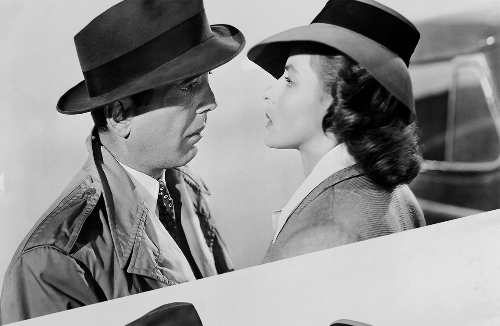

I thought this was working for a moment, but it is not compressing the right edge, just shifting it up.
Its the same result as Free Transform, but the out of bounds pixels wrap around from the bottom.
