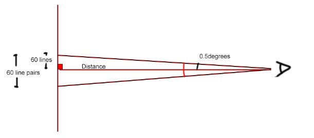

"There is a formula (that I can never remember)"
This one   :  ppi required = 6878/Viewing distance
It comes from the following :
A good human eye can resolve 60 line pairs per degree i.e. pairs of black and white lines.  So in half a degree we would have 60 single lines.
Simple trigonometry means that the width containing those 60 lines can be calculated by:
               Width of 60 lines = Viewing distance x tan(0.5°)
Once we know the width for 60 lines (or pixels) we can calculate how many lines per inch can be seen by using 60/Width of 60 lines.
So putting those together gives us
60/(Viewing distance x tan(0.5°)) = 60/(Viewing distance x 0.0087269)
= 2/(Viewing distance x 0.000291)
= 1/(Viewing distance x .0001454)
