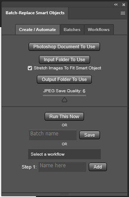

    Yes, this is very easy to automate inside of Photoshop. However I don't think you can do is using Actions, as you originally suggested. (At least, I've never seen an effective way to automate mockup image creation using Actions.) Instead this can be automated using either a Photoshop plugin, or using a Photoshop script.
    Using a plugin is the easiest method, especially if you're not experienced writing computer programs. You can use the Batch-Replace Smart Objects plugin for Photoshop to get this fully automated + operational with about literally 10 seconds of work:
    1) Select what Photoshop document you want to use (ie, your mockup template);
    2) Select your input folder of images (ie, your artwork designs);
    3) Select your output folder to save to;
    4) Click "Run This Now", + it will automate the process for you + create all your images.
    Then if you have lots of mockups you need to create (like if you create several different product mockups for each of your new artwork designs), you can just create multiple-step operations + run these as needed. As long as your workflow is standardized (ie, you put your new artwork designs in the same input folder each time, and you want to save your final prepared mockups to the same output folder each time), you can just save these operations / workflows and run them with one button click using this plugin.
