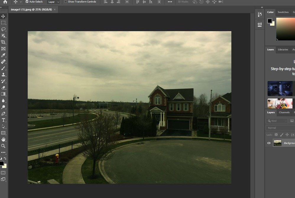

Everytime I open an image in Photoshop the colors of the image are off from the actual. I found a way to fix that by doing View>Proof Setup>Monitor RGB, and then enabling Proof Colors. However everytime I open photoshop proof colors is disabled again so I was wondering if there was anyway to keep proof colors enabled? Also if I fixed the issue in a bad way or it can be fixed without enabling proof colors please let me know. I attached what it looks like without proof colors (left) and with proof colors (right).

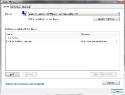

You have a defective monitor profile, probably delivered by a Windows update.
Windows 10 is known to install low quality profiles from monitor manufacturers when doing updates.
Photoshop relies on a sound and correct monitor profile to display correct colors.  When you use View>Proof Setup>Monitor RGB, you are bypassing the monitor profile, and disabling color management, which sort of "fixes" the issue.
Try setting the monitor profile to sRGB (use Adobe RGB if you have a wide gamut monitor).
If this fixes the issue, it is recommended that you calibrate the monitor with a hardware calibrator.
This will also create and install a custom monitor profile that accurately describes your monitor.
Press the Windows key + R, type colorcpl in the box, and press Enter.
Add the sRGB profile, then set it as default.
If Photoshop is running, it has to be restarted to become aware of the new profile.

To find out if this is the issue, I recommend you to try setting the monitor profile for your own monitor display under “Device” in your Windows ‘color management’ control panel to sRGB. You can ADD sRGB if its not already listed.
And be sure to check “Use my settings for this device”.
(OR, if you have a wide gamut monitor display (check the spec online) it’s better to try Adobe RGB instead).
Quit and relaunch Photoshop after the control panel change, to ensure the new settings are applied.
If this change fixes the issue, it is recommended that you should now calibrate and profile the monitor properly using a calibration sensor like i1display pro, which will create and install it's own custom monitor profile. The software should install it’s profile correctly so there should be no need to manual set the control panel once you are doing this right.
Depending on the characteristics of your monitor display and your requirements, using sRGB or Adobe RGB here may be good enough - but custom calibration is a superior approach.

I'm pretty sure that this is caused by a defective monitor profile, the yellow cast in the white patch in the Color panel as well as the Hue cube is a giveaway.
