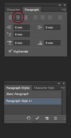

When Adobe introduced text styles they changed what was already a difficult scripting problem into a rats nest.
I think what is happing is if the text has a style override( noted by the + in the style name ) then you can't access most of the text properties using the DOM.
The Action Descriptors change radically if the style has an override. For example the justification setting is found in different in different descriptors depending on if the style has an override.

Hi
Doesn't work with aLay.textItem.size. Comes up empty. This is when you change the justification from the Paragraph panel. Here is a screenshot,
Now, if you try to get the font size, you get nothing.
