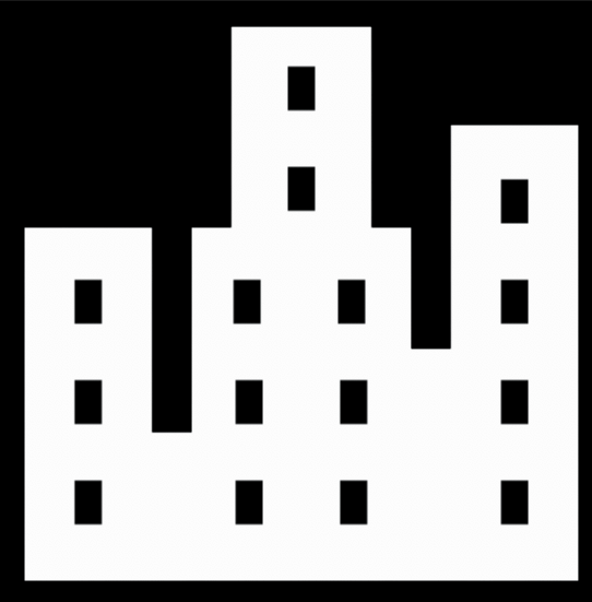

I have a building with windows and I'm trying to figure out how to cut the windows out so the background color displays. Right now the windows are a black shape.
I can't seem to figure this out. Any direction would be greatly appreciated.

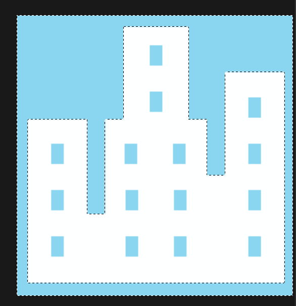

If your building is just one layer, this means that your layer is made by both the black color and the white building, just use the Magic wand tool in order to select the black windows. Once you selected the windows, just press the delete or backspace key on your keyboard and you will have a hole, through which you can see the Background layer.
When using the Magic Wand tool, be sure to uncheck the "Contiguous" option in the upper option bar, otherwise you will select also the black background of the layer.
If you feel like to be more advanced, instead of deleting the black holes, just apply a layer mask, If you do not know what is that, no worries, you will get there once your Photoshop skills will advance.

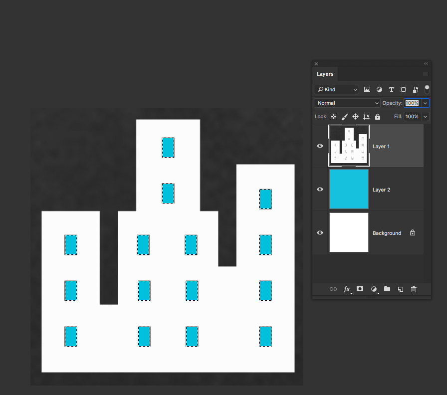

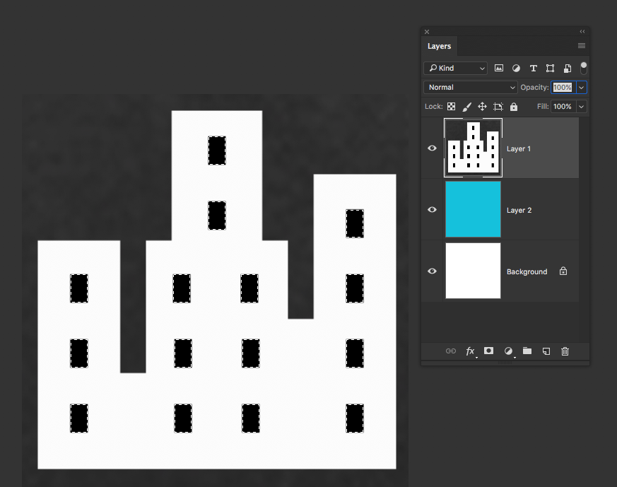

Here's a screenshot of layers.
You can see all the black window shape layers.
Below that is a smart layer of the white building. It's also comprised of white shape layers.
If I try to select a black window layer and use the magic wand to make a selection, the magic wand won't allow me to make a selection. I have to rasterize the window layer first. But the cut out result will obviously just reveal the white building layer underneath. I still can't figure out how I can easily cut through both layers - window and building.
Seem like I should be able to select both layers, make the selection and cut through. Easier said than done for me.

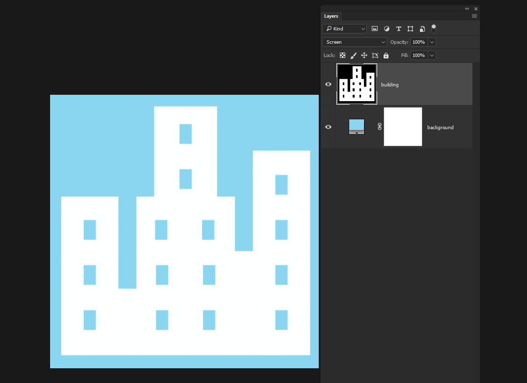

Just a variation on Martin's explanation.
1) starting with the original black and white building you just want to punch holes in the windows to reveal the background
2) Add a color overlay layer to provide the background color and set the blend mode of the upper (building) layer to 'Screen' This will cause the black elements of the graphic to disappear and reveal the background.
3) With the building layer selected, use the magic wand tool with a tolerance of '0' and 'Contiguous' checked to make a selection
4) Now select the layer mask on the color overlay layer and fill with black. In other words have black as your foreground color and press alt-backspace on the keyboard for a PC and option-backspace for a Mac. This will fill the selection and create a mask with just the blue color overlay revealed behind the windows.
