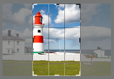

You still didn't post an image so that we could give you specifics so I'll demonstrate with one of mine. I will have shown two methods below. Which is best - depends on the image:
Method 1.  If you start with a landscape and want no distortion then you will need to crop.
So starting with this (which is in a 3:2 ratio) :
Select the crop tool and enter the ratio you require in the options bar - I will choose 2:3
Note by leaving "Delete Cropped Pixels" unchecked , I can go back an re-crop later if required

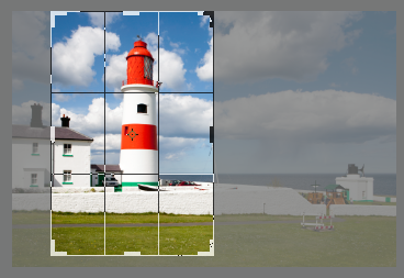

Now drag the crop area till You get the crop you want :
Then hit enter or click on the tick in the options bar
Job done.
