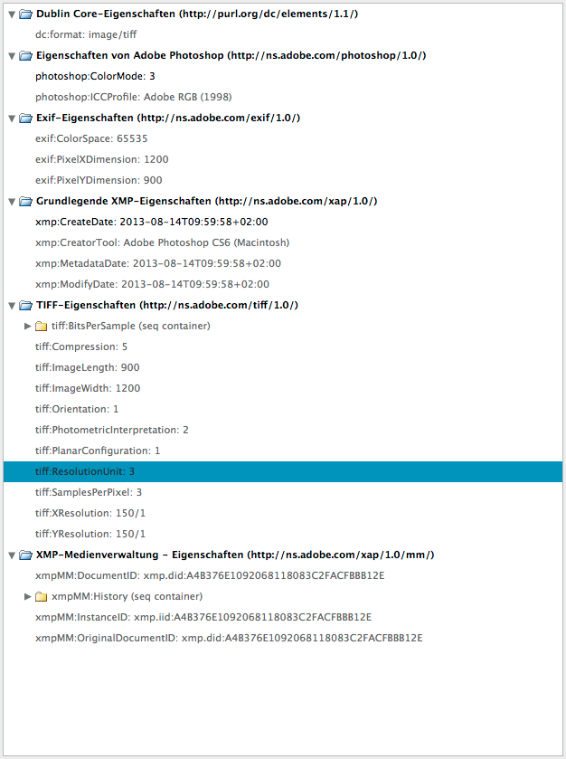

New Here ,
Aug 14, 2013 Aug 14, 2013
Michael, thank you very much for your code. I tried it and played around with it. It kinda works... the file itself gets modified and when I inspect the metadata of the image, I see all the values I changed. Especially ResolutionUnit = 3...
...but when I reopen the image in Photoshop, it still has the old values. Photoshop seems to ignore the changes.
See this screenshot of the metadata information: (the old value of ResolutionUnit actually was 2... just dont have a screenshot of that right now)
and compare it with the information in the "resize image dialog":
These are the complete metadata Photoshop shows me...
... where the hell does Photoshop get the "wrong & old" information seen in the 2nd screenshot? Any ideas? 😕
Daniel
