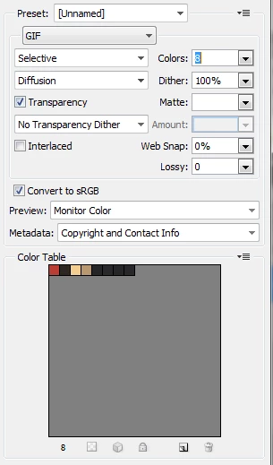

New Here , Dec 25, 2020 Dec 25, 2020
how to reduce number of colors in an image is easy in Photoshop.
try to save as GIF. or save for Web and Devices (Alt+Ctrl+Shift S)
Preset using GIF
colors to 4
Preset using GIF
colors to 4

Can you show how to do this on mac's version or maybe a more recent release of photoshop? This looks like something I saw back in the 90s
May 19, 2021 May 19, 2021
By @Sean98A5
This is on a Mac with PS 22. Nothing has changed with Save for Web (Legacy).
~ Jane
