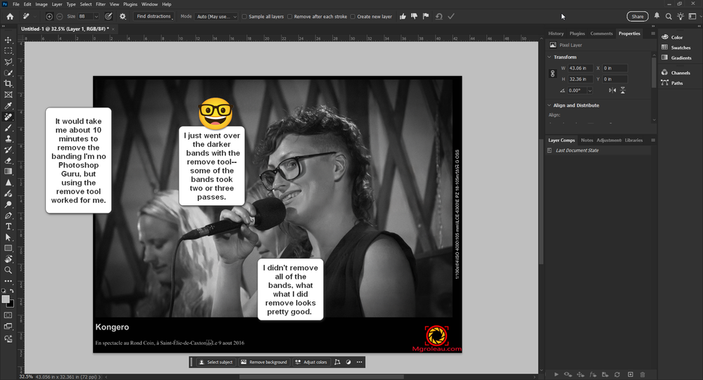

Valorous Hero ,
Aug 04, 2025 Aug 04, 2025
That looks pretty good.  I'm lazy:  I just used the remove tool and it did a pretty good job on what I did do.
