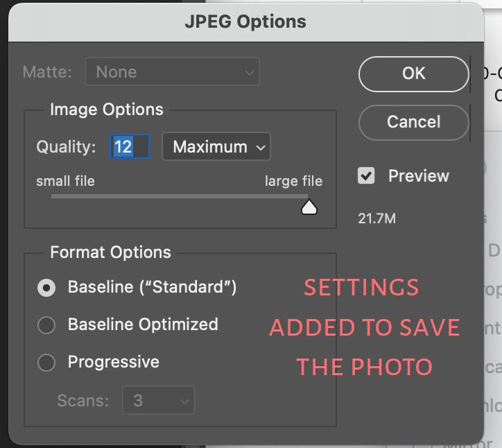

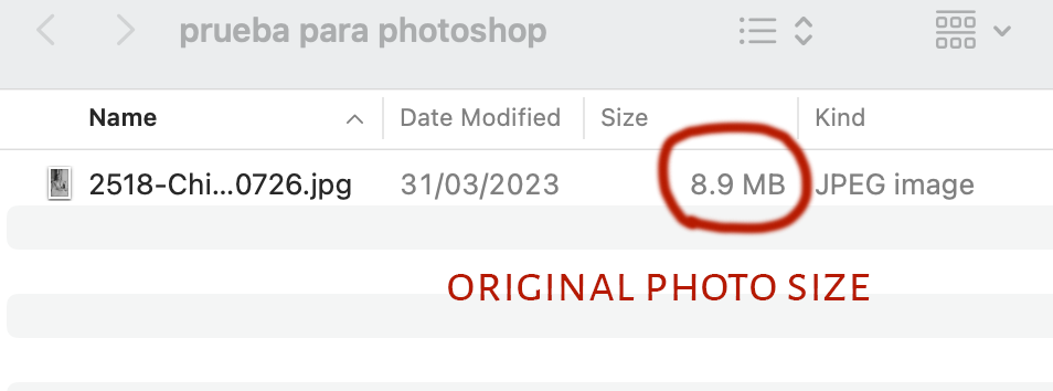

Hello, how are you? i would like to ask something regarding save of files. Its been happening to me that when i save an image that has been retouch, this is, i press Control + S (Save) JPEG OPTIONS - Quality 12 Maximum - Format options: Baseline ( Standar). When i save with this settings i can see that the photo is actually increasing the Mega Bites a lot (the original photo is around 9 MB and it is saving in 23 MB in some cases). As a result, i started to have a few photos with Grain on them (Photoshop is adding pixels to it and i don't want this to happen anymore). Please, can you advise me what is the solution for this ? Maybe i am using the wrong settings, in that case, please, can you let me know how to keep the same quality of the original photo? I would really aprecciate your help on this. Thank you in advance for your time!

Hello Kevin, Sure, here are the screenshots. Hopefully you can help me with this ? xx Thanks in advance1.png2.jpg3.png

Was the original a JPEG format image, and if so do you know what the Quality level was of the original? For example, the size might go up if it was originally JPEG quality 8 and it is now being saved at JPEG 12.
The visual difference betwen JPEG 10 and JPEG 12 is so small that the eye usually cannot see it, but the file size increases significantly. So you could save space by trying JPEG 10.
Because JPEG is a lossy compression method, it can never keep all of the quality of the original. If you must keep all of the quality of the original, the file must be saved using the lossless compression in formats such as TIFF or PNG.

Hello Conrad, how are you? the original file is a JPEG exported by lightroom. the photos haven't been in photoshop before. So i don't really know if they were quality 8. The only thing is clear is that i am increasing the size of the photos. Would you suggest as a solution to save the files in quality 8 and not in 12? I already try this and apparently is keeping the same size of the original JPEG file. My question is if in this way i will keep all the information and quality of the original? let me know.... thanks ....

The way this is often done is that when you are adjusting the JPEG quality level in the Save As or Save a Copy dialog box, use the Preview option and watch the image in the window. Disabling Preview shows the original, enabling shows how the current JPEG settings look. Disable and enable Preview, and compare the visual difference. The difference is easier to see if you zoom in. If you see a difference when disabling and enabling Preview, then you might set it higher. If you set it at 9 or 10 and you no longer see a difference when comparing with Preview, then that is good enough.

The right number can be different for each photo, that is why the Preview is provided. Also, file size can go up depending on what edits were done. Photos with more details are more difficult to compress, so for example, if an image details or noise/grain were enhanced by sharpening, the new image may require slightly more space.
