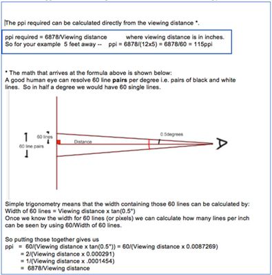

hi D.Fosse, Here's a PPI / viewing distance formula posted a while ago by DavesCM
it might require a bit more explanation.
I hope this helps
I hope this helps

Jan 04, 2023 Jan 04, 2023
@Zower thanks for that, I hope it helps you arrive at a good solution to your issue
