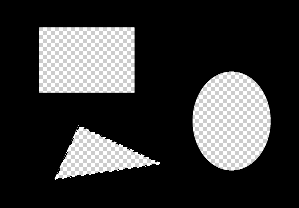

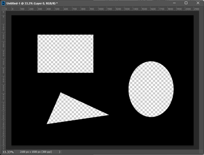

Sure, no problem! Here's an example. I would like a script that results in a rectangular, circular, or triangular selection:
I recently found a clever script that's I'm trying to adapt to work for my needs (like apparently it isn't possible for a script to save a RAW without dialog?) at the very bottom of this thread: https://community.adobe.com/t5/photoshop-ecosystem-discussions/get-index-of-each-pixel/td-p/10022899

@gregd - How would the script know which of the three transparent areas should be selected? You mentioned arbitrary selection, so using a "random" operator?
As far as I know, multiple selections are just a single selection in scripting, at least in ExtendScript, I don't know about in UXP.
A selection can be converted to a path, with various degrees of accuracy. Unlike selections, paths are separate items that can be programmatically isolated from the overall collection.
So, I can envisage a script that loads all transparency as a selection, converts the selection to paths, which could then be used to individually isolate or select the pixels from the underlying area, based on the "approximate" path coordinates, but using the accuracy and fidelity of the pixels identified by the paths.
