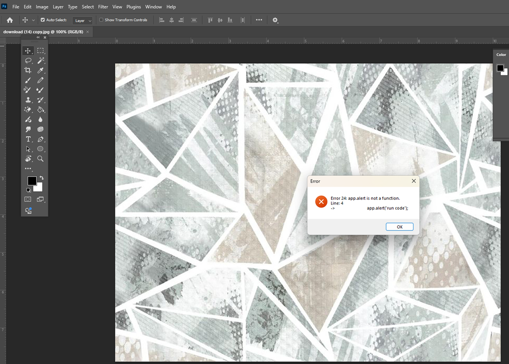

Contributor ,
Oct 18, 2024 Oct 18, 2024
Ok, I am putting this code in my script. You tell me if this is right. I don't know much.
Contributor ,
Oct 19, 2024 Oct 19, 2024
You can't use this script in Adobe Acrobat.
You must move all the code inside the curly brackets, next to the "put code here" comment.
Contributor ,
Contributor ,
Oct 20, 2024 Oct 20, 2024
Hi @MJ ST ,
Instead of using "alert" define the alert popup messaging function with the appropriate Acrobat JavaScript syntax: "app.alert":
app.alert("You must have a document open to add the filename!\nVous devez ouvrir un fichier image pour y jouter son nom de fichier." );
That should work now.
