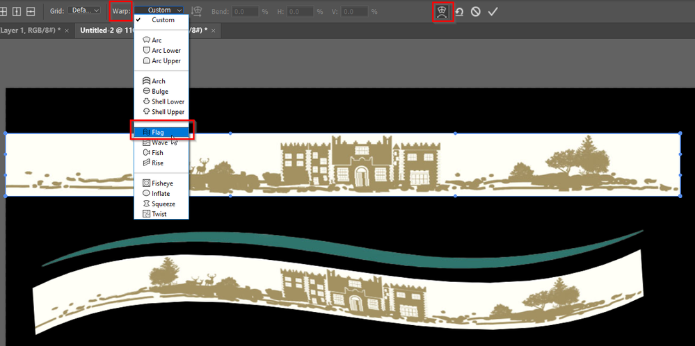

If you want to make this sort of shape, then Free Transform > Warp > Flag will do this for you.
If you want the graphic ti taper like the brush stroke, then that's a bit harder and will take more steps.
Start with FT > Warp (by right clicking) and taper the ends

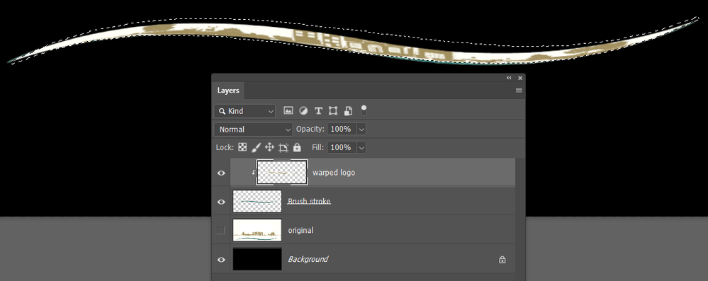

image.pngThen use FT > Warp > Flag again.  Note, if you can't get the required warp in one go, the OK it and take another stab

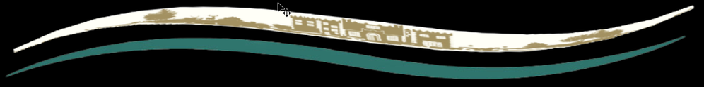

image.pngTo get it to fit exactly, you can clip the warped layer to the brush stroke layer, but you need to done some work to get a decent fit.
I've overlaid the warped logo layer above the brush stroke layer.
Right click the logo layer and chose Create clipping mask
What this does is use the lower layer as a mask.  I've used the marching ants (selection) to show the true outline of the logo, but it only shows where it overlaps the layer it is clipped to.
Does this help?
