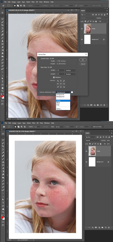

Have you tried using the Guide Layout feature to have Photoshop do a lot of the division math for you, as in the animation below?
If I understand what you’re doing, the artwork not only needs a 1.5 inch overlap between panels, but 1.5 inches of extra canvas around the entire artwork for the stretcher bars. If so, then the first step is to extend the Photoshop canvas beyond the artwork, also shown below.

Thank you for putting that together. Yes, I did try the guides but I was getting mentally stuck with the extra spacing around the image. My boss who wants this done doesn't want a "white space" on the edge of the canvas - just the print. Maybe if I make the canvas color something that blends with the image, it will work OK.
Aug 07, 2020 Aug 07, 2020
Yes, that’s what I would suggest. I’ve run into the same thing where I wanted to canvas wrap a print, but important parts of the image content were so close to the edge that they would have ended up on the side or back if I had wrapped the image edge itself. And I didn’t want a white wraparound color either. So I used the same idea you just mentioned. After expanding the canvas to provide overlap, I drew a big rectangle shape all the way out to the new expanded wrap edge, filled it with a solid color sampled from the image, and layered that behind the image.
The other way to do it, which sounds like the direction you were going in, is to set the background color to whatever you want, then when you go into Canvas Size you can set that as the Canvas Extension Color.
Either way, it’s the same as in the animation except with a color other than white in the canvas area around the artwork.
Another thing some people do is repeat the art around the edge but mirrored, so that it meets up with the image on the front. Haven’t tried that yet.
