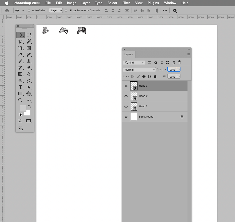

This would raise a file-selection-dialog for a txt-file along the lines of the example you posted, then place the images.

May 19, 2025 May 19, 2025
@elliotstoner – How did you go with the script offered by @c.pfaffenbichler ?
Community Beginner ,
@c.pfaffenbichler @Stephen Marsh It works! Thank you SO MUCH! I had to make a few small adjustments, and added some comments for clairity - here's what I ended up with:

 *    imageName,xOffset,yOffset (each on a separate line)
 *    example: Image 1,-3,4.5
if (app.documents.length > 0) {
  // Save prefs
  var originalRulerUnits = app.preferences.rulerUnits;
  // Setup
  app.preferences.rulerUnits = Units.PIXELS;
  app.runMenuItem(charIDToTypeID("FtOn"));
  var theFile = selectFile(false);
  var theFiles = readText(theFile);
  var myDocument = activeDocument;
  var thePath = myDocument.path;
  var docWidth = myDocument.width;
  var docHeight = myDocument.height;
  // The root directory is the location of the base file - put all of your images in a
  // subfolder in the same directory as your base file, and put the name of that folder here.
  var subFolder = "6in width";
  // Place images
  var thisOne = theFiles[0];
  placeScaleRotateFile(
    thePath + "/" + subFolder + "/" + thisOne[0] + ".psd",
    docWidth / -2 + thisOne[1] * 300,
    docHeight / -2 + thisOne[2] * 300,
    100,
    100,
    0,
    false
  // assumes the images have the same dimensions;
  var xOffset = myDocument.activeLayer.bounds[0] * -1;
  var yOffset = myDocument.activeLayer.bounds[1] * -1;
  myDocument.activeLayer.translate(xOffset, yOffset);
  for (var m = 1; m < theFiles.length; m++) {
    var thisOne = theFiles[m];
      docWidth / -2 + thisOne[1] * 300 + xOffset,
      docHeight / -2 + thisOne[2] * 300 + yOffset,
      100,
      100,
      0,
      false
  // Reset prefs
  app.preferences.rulerUnits = originalRulerUnits;
// ------- Helper Functions -------
// Place File, Scale, and Rotate File
function placeScaleRotateFile(
  file,
  xOffset,
  yOffset,
  theXScale,
  theYScale,
  theAngle,
  linked
  var idPxl = charIDToTypeID("#Pxl");
  var idPrc = charIDToTypeID("#Prc");
  var idPlc = charIDToTypeID("Plc ");
  var desc5 = new ActionDescriptor();
  var idnull = charIDToTypeID("null");
  desc5.putPath(idnull, new File(file));
  var idFTcs = charIDToTypeID("FTcs");
  var idQCSt = charIDToTypeID("QCSt");
  var idQcsa = charIDToTypeID("Qcsa");
  desc5.putEnumerated(idFTcs, idQCSt, idQcsa);
  var idOfst = charIDToTypeID("Ofst");
  var desc6 = new ActionDescriptor();
  var idHrzn = charIDToTypeID("Hrzn");
  desc6.putUnitDouble(idHrzn, idPxl, xOffset);
  var idVrtc = charIDToTypeID("Vrtc");
  desc6.putUnitDouble(idVrtc, idPxl, yOffset);
  desc5.putObject(idOfst, idOfst, desc6);
  var idWdth = charIDToTypeID("Wdth");
  desc5.putUnitDouble(idWdth, idPrc, theYScale);
  var idHght = charIDToTypeID("Hght");
  desc5.putUnitDouble(idHght, idPrc, theXScale);
  var idAngl = charIDToTypeID("Angl");
  var idAng = charIDToTypeID("#Ang");
  desc5.putUnitDouble(idAngl, idAng, theAngle);
  if (linked == true) {
    var idLnkd = charIDToTypeID("Lnkd");
    desc5.putBoolean(idLnkd, true);
  executeAction(idPlc, desc5, DialogModes.NO);
  // get layerid;
  var ref = new ActionReference();
  ref.putProperty(stringIDToTypeID("property"), stringIDToTypeID("layerID"));
  ref.putEnumerated(
    charIDToTypeID("Lyr "),
    charIDToTypeID("Ordn"),
    charIDToTypeID("Trgt")
  var layerDesc = executeActionGet(ref);
  var layerID = layerDesc.getInteger(stringIDToTypeID("layerID"));
  return [app.activeDocument.activeLayer, layerID];
// ------- Read input file ------
function readText(thePath) {
  if (File(thePath).exists == true) {
    var file = File(thePath);
    file.open("r");
    file.encoding = "BINARY";
    var theText = new String();
    for (var m = 0; m < file.length; m++) {
      theText = theText.concat(file.readch());
    var theArray = theText.split("\n");
    for (var n = 0; n < theArray.length; n++) {
      theArray[n] = theArray[n].split(",");
    file.close();
    return theArray;
// ------- Select input file ------
function selectFile(multi) {
  if (multi == true) {
    var theString = "please select files";
  } else {
    var theString = "please select one file";
  if ($.os.search(/windows/i) != -1) {
    var theFiles = File.openDialog(theString, "*.txt", multi);
  } else {
    var theFiles = File.openDialog(theString, getFiles, multi);
  // Filter files for Mac
  function getFiles(theFile) {
    if (
      theFile.name.match(/\.(txt)$/i) ||
      theFile.constructor.name == "Folder"
      return true;
  return theFiles;
May 15, 2025 May 15, 2025
