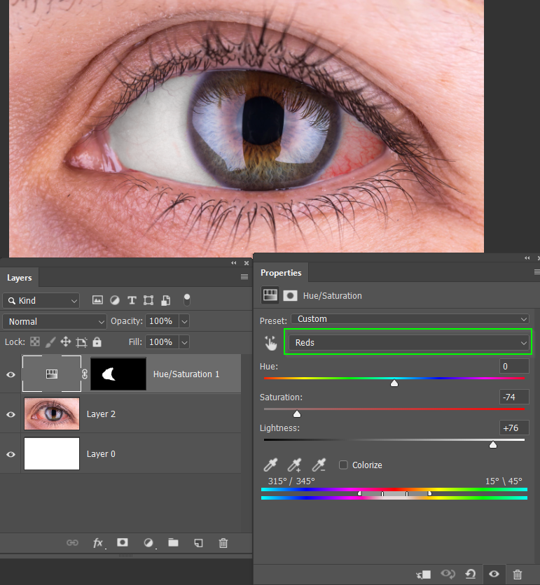

Thanks for the help, here is a sample of the eye.
Dec 12, 2018 Dec 12, 2018
Using this as an example
Add the Hue/Saturation layer as Dave suggested, and set it to target the Reds
Reducing the saturation will leave the lines as dark grey, so we also need to increase Lightness.
The skin around the eye has a lot of red in it, so we need to restrict the effect to the iris by inverting the layer mask to fill it with black, and painting with white where we need it to work.
Nice job Trevor.
Jani - If you use the method shown above make sure you leave some trace of the blood vessels there (as Trevor has done) or it will look unnatural.

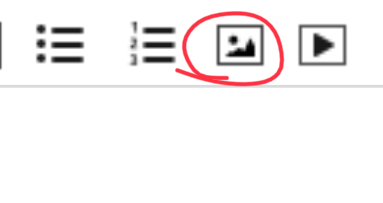

That message is blank. You may have tried to send an email attachment. Go to the link for the thread
I need help with taking out the red on a eye (on the white part )
and click the Insert Image button (circled below).
