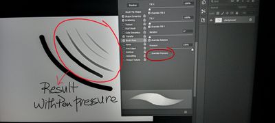

Ive been trying to figure this out for days, but can someone tell me why my brush on photoshop is coming up round at the end like this
instead of having sharp  ends  like this
let me know how i can make my brush have sharp ends ! id really appreciate the help

To get both ends pointed, you need to make a path (not a Shape) that follows the way you want your line to go. Once you have the path, select the Brush, and in the Brush Settings panel, under Shape Dynamics, set the size control to Pen Pressure. Then, open the Paths panel menu (the three lines), and select Stroke Path. A small dialog opens, where you can select the tool you want, in this case, the Brush. Make sure the Simulate Pressure box is checked, and click OK.

Thanks, i did that but i wanted to draw with my brush without haveing to use the pen all the time
I wanted to have sharp end points while drawing with my brush but it came out round all the time like i showed in the photo above.

Use a pressure sensitive pen and tablet, start with low pressure, increase pressure in the middle of the stroke, decrease pressure again at the end of the stroke.

Wait, i had the same problem just a while ago, and i figure it out recently..
so, first you need some pen tablet or display tablet, both are needed for the pressure sensitivity, then open the brush setting, you can open it in window -> brush setting / (F5) then go to shape dynamic - control and change to pen pressure.
And yeahh... you can have a pointy brushes, maybe you can adjust a little bit like you want to make it more comfortable for you work with that brush.

Every time I pick a brush, transfer settings set automatically.
This transfer setting is not turning off.
Because of this, the brush strokes becoming transparent. If override pen pressure on every brush edges become rounded again
 What should I do for dark pointy edges brush strokes please anyone can help me 
