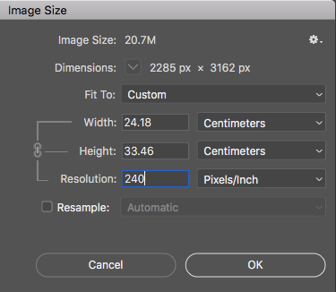

Scaling is where you uncheck "resample" and decide what size you will print. If the ppi is above 220, I think you will have a decent print. 300 is a holdover from offset presses. 240 ppi would be for a 4 color consumer inkjet. Scaling will not subtract or add pixels, it just decides the size on paper.  And as D. Fosse pointed out, if it's large, then that is reduced as you move away to take in the whole print.
Here's the dialog with resample unchecked. You can adjust print dimensions (inches or cm) and see what the ppi will be.
