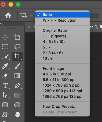

Jul 31, 2020 Jul 31, 2020
You can set up your own Cropping presets or use the ones that come with Photoshop (see screenshot below).
Obviously if your desired aspect ratio for your prints is different from the camera's you must crop the image a little, that isn't normally a problem.
Make sure you have a minimum of 200PPI in your final image.
