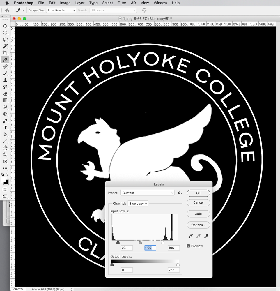

I have a green logo on a white background and I am trying to invert the colors with a transparent background and have the logo white and the background green. The text is pretty thin so when I try to remove the background it takes away from the image.
Correct answer rob day
Do you mean like this?
The Blue channel is almost a  mask, so I duplicated and inverted it, then forced it to black and white with Levels—the duplicate channel can now be loaded as a mask:
rob day
rob dayCommunity ExpertCorrect answer
August 9, 2021
August 10, 2021
Yes but when I get it to the black and white how do i get it back to the green and white.
D Fosse
August 10, 2021
Use it as a mask on a green color layer. Done 🙂
