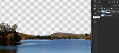

Inverting a layer mask is not the same as inverting a layer - your original question was vague and lacking context prohibiting any meanigful answer. You explanation of watching tutorials and they all seem to include inverting a layer MASK makes much more sense and is a common practice. When creating a layer mask we often begin with a selection. It's often easier to select the oposite of the intended mask and requiring we invert the mask to hide to correct parts. The opposite of black is white, so if you have the wrong part of your image masked, simply cmd / ctrl i to invert the mask and now the correct part is masked - make sense? Let's say you want to replace a sky (not using the new cool filter, but the "old" way) - first you would select the existing sky because it's much easier to select than the rest of the image:
 Then I would click the new layer mask icon at the bottom of the layers panel and I have successfully masked out everything BUT the sky.
I want the sky to have the mask and I need to invert the layer mask to get there. So here I have done my keyboard shortcut to invert and now I can add a new sky in the layer below .

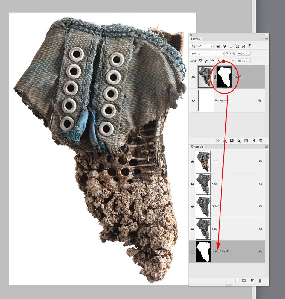

Seems like you are referring to a Layer Mask and not the actual Layer?
A Layer can have a Layer Mask which is a grayscale Channel that will hide or show areas of the Layer without actually removing the Layer’s pixels. You target the Layer Mask by clicking on it in the Layers panel—clicking on the Layer icon targets the actual layer:
The Layer Mask targeted
If I paint on the Layer Mask with black (inverting the white areas of the mask) it hides the image where I paint:
Painting with white (inverting the black areas) reveals the layer image:
