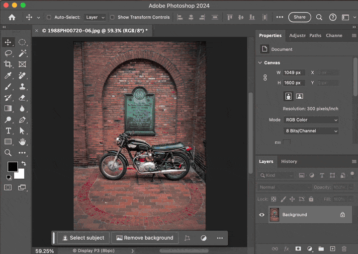

Does the demo below show what you mean? If this is what you want, you can see that with the updated Gradient tool, it was done in only a few seconds, and it can be edited at any time.

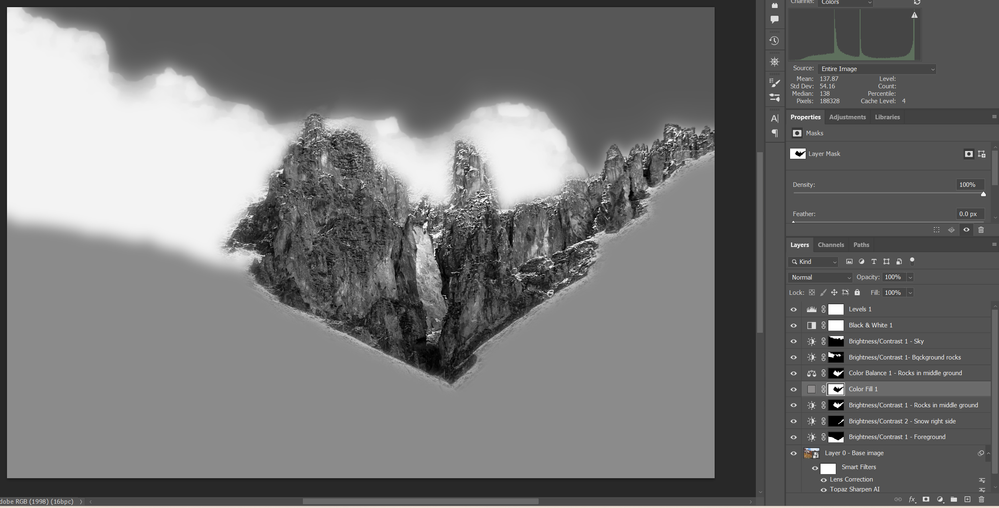

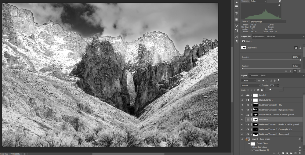

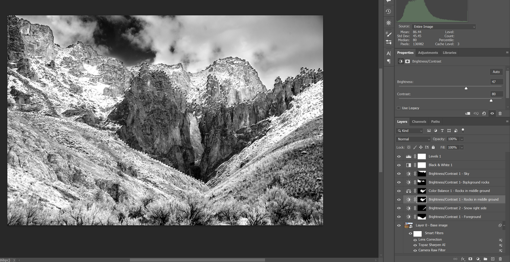

I believe that's what I did.  Here is a screen capture of the image and the layers panel.  The part that's selected is the darker colored rocks in the middle and leading off to the right edge of the frame.  What you see is an almost final version of the image.  At this point my interest has shifted to just seeing if there's another way to do this, like what you've suggested.
    Bill
Here it is with the Color Fill layer:
Here it is after the Image > Adjustment > Invert.  What concerns me is that the background are covered with a much lighter color of gray than others areas.  This area was not part of the initial selection, but seems to be acting like it was.  I expected it to be the same gray color as other areas.
After applying the Gausian Blur there's a small area outside the selected area that is now visible.
And now with opacity set at 25% here's what resulsts.  The background rocks / ridge  is now much lighter than it should be.
Hope this gives you some "diagnostic" information.
      Bill

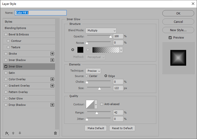

Feb 28, 2024 Feb 28, 2024

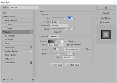

Here's another way you could do this using a Color Fill layer: With your selection active, make a new Color Fill layer. In Blending Options, set Fill Opacity to zero percent. Add a Stroke, with Position set to Inside, Fill Type set to Gradient, Style set to Shape Burst, and a Black to Transparent gradient.
[EDIT]
Better than a Stroke, use Inner Glow, with color set to black, Blend Mode set to Multiply, and Source set to Edge.

I've tried many times and I think I'm doing what you outlined above using a stroke, but the gradient never gets applied to the selected area.  For the Inner Glow method I think I understand the basic concept of what you are doing, which seems simple and straightforward, but it doesn't work for me.  When I get to the Layer Styles panel I have all the parameters set to values that are shown in your examples.  The preview shows something that should make a difference, but when I click on the OK button no change is made to the image.  I'm probably doing something wrong, but I can't figure out what it is.
    Bill

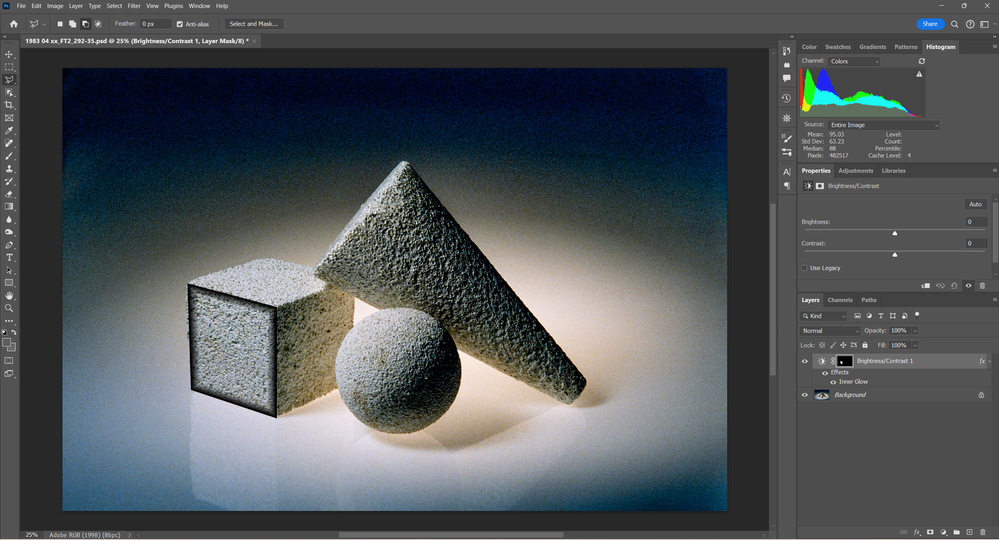

Engaged ,
Feb 29, 2024 Feb 29, 2024
I've finnaly had some success when using a much simpler image.  Here's what I did:
1.   I made a slection on my base image (layer 0) of the front surface of the cube and copied the selection to a new layer (Layer 1) above the base image.
2.  With Layer 1 selected I then selected Layer > Layer Style from the menu at the top of the screen.
3.  On the Layer Style pop up window I selected Inner Glow.
4.  I then adusted the parameters available on the Layer Style pop up window.
5.  These actions generated an Inner Glow Effects adjustment added to Layer 1.
It did what I wanted.  I suspect this is almost the same as the second method suggest by Semaphoric.   I will continue to experiment.  When I tried to apply it directly to a selection on Layer 0, it applied the adjustment to the entire image, not just the selection.  It worked fine when applied to a Brightness/Contrast layer (Layer 1) that had the front side of the cube selected.
Thanks to all of you who helped me add another technique to my tool bag.
