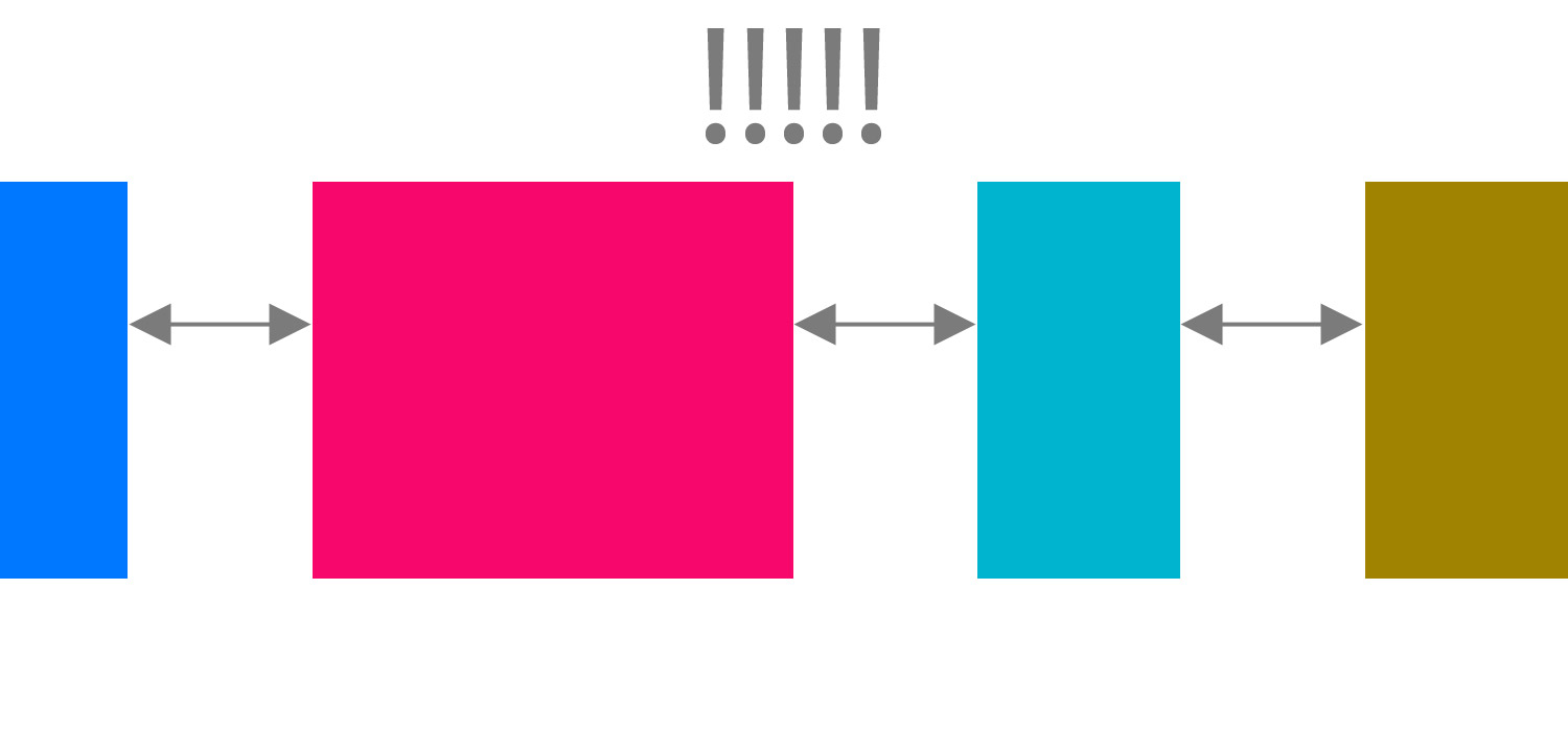

Hi, I'm designing a wedding book where I have to line things up nicely. I use smart guides and snap to... and those are great for lining things up in a row (for example the tops and bottoms of the shots here) But the vertical lines are where I'm having trouble . I'm good at eyeballing how far I want things apart, but there has to be a more exact way to space out the images quickly and evenly. (in this shot I have not lined them up yet... My eye is better than this
) It's just one of those things that I finally remembered to ask
Thanks in advance,
Cortney

Photoshop does not have "Distribute Spacing", which is what you are looking for.
Illustrator or InDesign would have that type of distribution for your layout. It would be a handy feature for Photoshop to have too.

It doesn't matter the distance between them, its different every time so they are or are not evenly spaced.
Its NOT the horizontal lines I'm worried about. That snaps nicely!
Its the vertical lines (as in this picture above) the space BETWEEN the images. I have to eye ball it or shift+arrow three times or whatever...

Photoshop does have distribute, just select the layers and use Layer -> Distribute -> Horizontal Centers
That is not what the OP is asking. They want EVEN SPACING between pics.
Cortney: when I have something like this, I just eyeball the spacing, then drop in a white line using the line vector Line Tool set to just a tad wider than the spacing. A bit of a PITA, but keeps everything consistant.

Using distribute will space the layers with the same spacing between them. The script that has been ticked as the correct answer will not it will only space them to the given pixels entered. I know as I wrote the script! You will of course have to set the left and right pictures first before doing the distribute.

Your script works great. Cool! But going Layer>Distribute Horizontal Centers does not create even spacing between the images, unless I'm missing something.

Charles,
I must apologise unreservedly! I was using same sized pictures and then it does space evenly.
It looks like I might need to write a script to do this!
Once again my apologies!
