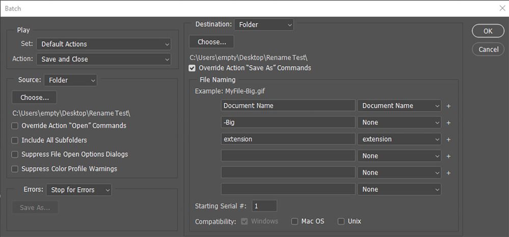

If you want to do it in PS, its pretty easy. First, create an action that just saves and closes a file. You only have to do this once. Then you can use File->Automate->Batch and set it up as below. Works a treat!

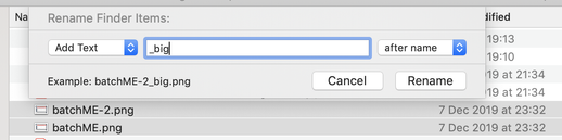

As you are on a later version of the Mac OS, the Finder has a very simple "Rename Finder Items" option... Simply select multiple finder items and you can then configure as required:

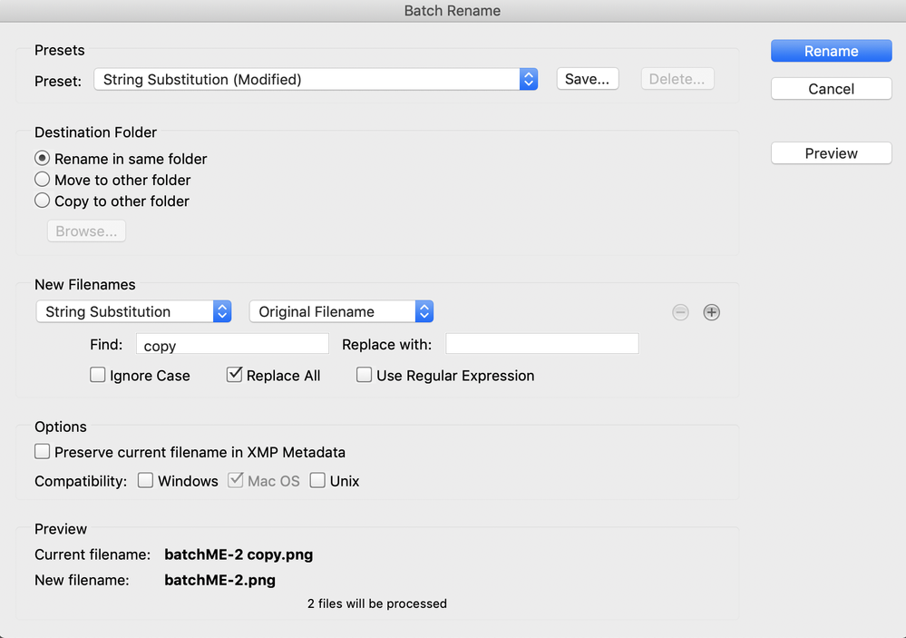

More info would be required on the exact step by step method that leads to having the unwanted " copy" added...
Yes, you can remove rather than add using an Adobe Bridge Batch Rename String Substitution (find/replace):
However, if you only wanted to remove the final " copy" from the text, then you would need to employ Bridge's more powerful "Regular Expression" based String Substitution feature:
Or another variation of the same theme:
