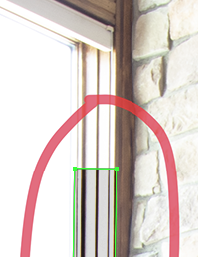

I hope you are doing well.
I'm trying to figure out what would be the best way to bring information back to the overexposed window frame. I have raw file. Is there a way to fix it?
If you could point me to the right direction I would really appreciate it.
Thank you!

Some pretty hard clipping on the highlights there. You could try this: use the Pen to make a mask for a Levels adjustment layer. In the Levels properties, drag the white point slider to the left, and drag the middle (Gamma) slider to the right.

If you have the raw file do it there with the Highlights slider. Opened in Photoshop it's already clipped and gone.

The point here is that the raw file may still contain recoverable data.
Once opened into Photoshop it's gone. If clipped in the raw conversion, it's not recoverable. Using the ACR filter will not change that.
