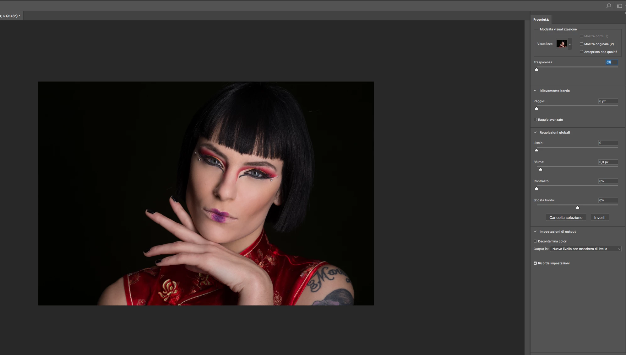

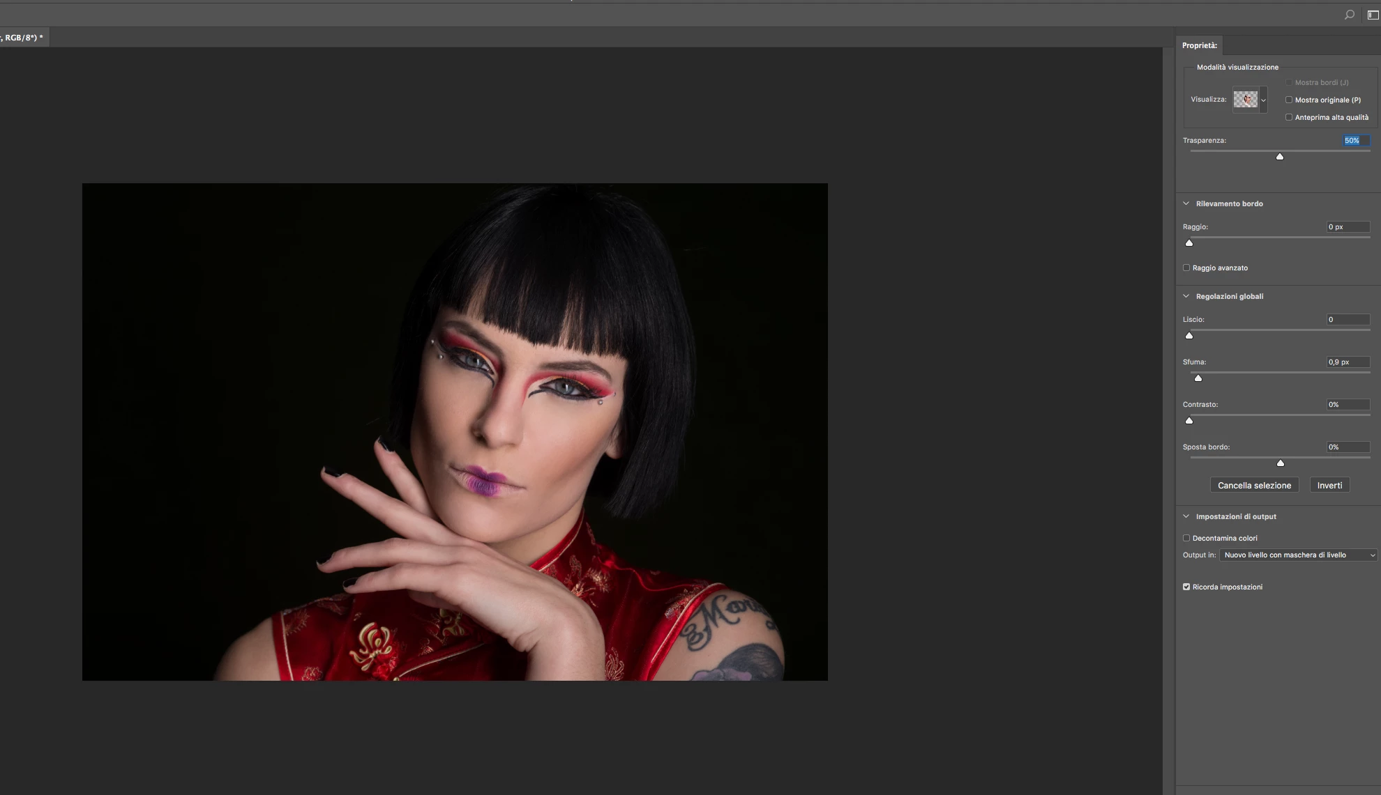

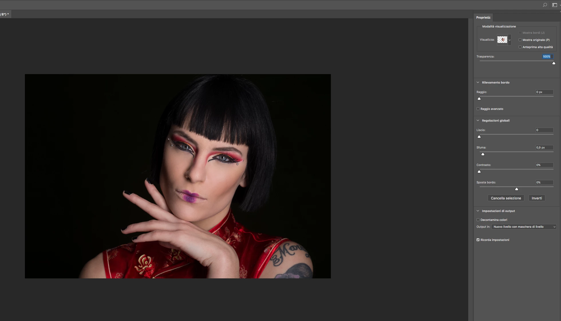

I apologize for the delay. However you will find attached the four screeshots you asked me, one with the layers and three with onion skin on a selection with three different transparency levels.
Hope that helps
Thank you
R
Hi
Thanks for posting those screenshots.
Are you sure onion skin is not working?
Onion skin shows the layer you are masking against the layers below. If there is no layer below , then it shows the masked layer against the transparency grid. (The transparency grid is always shown in the little icon at the top right regardless of the layers below) . Effectively it works the same as "On Layers" but with a variable transparency added through the slider.
Given that the layers below look the same (from your screenshot of the layers panel) it will appear that masking is doing nothing, even when there is a mask, as it is showing your masked layer against the same, or very similar, image below it.
As an experiment, can you temporarily add a different image between "Smooth 3" and "Selection layer" and check what that shows at different transparency levels?
