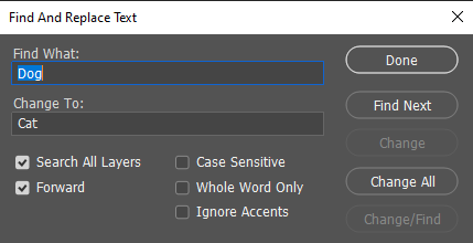

Yes the action conversion to Javascript by xtool does not work where the action does.
The Scriptlistener Code works and the cleaned up code by Clean SL works.  Here is Dog to Cat

In case it was not obvious, the code in the previous post works on an active (text) layer.
Adding some extra code, all text layers that contain Dog can be replaced with Cat – this is just a quick hack, I have not used a conditional to only process text layers:

Here is the DOM code instead of AM code:
app.activeDocument.activeLayer.textItem.contents = app.activeDocument.activeLayer.textItem.contents.replace(/Dog/gi, 'Cat'); // g = global, i = case insensitve
