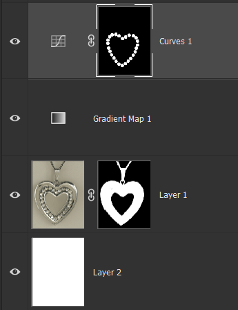

Andrewjmarino
June 29, 2021
Too bad there's no control over the photo. Your retouching life would be much easier and faster if there were.
This is one way your could approach it. (There are usually many ways to improve images in Photoshop.)
First make a selection of the jewelry so that you can separate it from the background and make the jewelry stand out more. Once I had the selection, I added a layer mask and put a white filled layer underneath it.
Next I added a Gradient Map to get rid of the mucky yellowish color.
A Curves adjustment layer with a layer mask that isolates the diamonds, makes the diamonds look more sparkly.
On a separate touchup layer, using the Brush tool with a white foreground color, clicked on the dark spots on the diamonds to turn them white.
Since you want a single layer, you could choose the Flatten Image command in the Layers panel menu.
Before doing that, you could also experiment with different background colors.
Thank you for your ideas.
I'll give it a go and see how far I can get.
I am far from a Photoshop wizard myself, but I am determined to learn more and get these lockets looking better.
Andrew

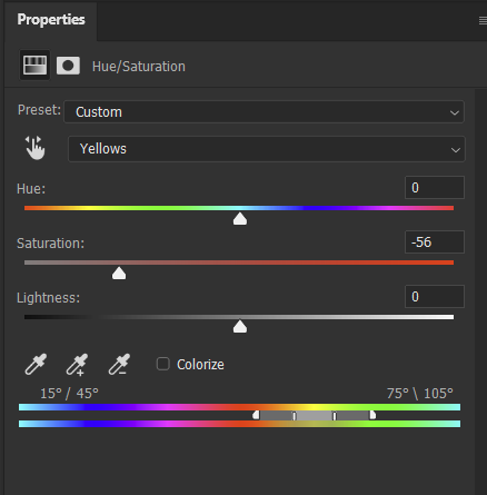

barbara_a7746676
June 27, 2021
The solution would be best treated by starting with the photograph itself and the lighting when the photo is taken.
The example will look dull and flat if you eliminate the black areas. The background should be much lighter, or even white so that the jewelry can be emphasized.
But if you must work with the photo that you have, you could start with the Select > Color Range command.
Then use a Curves adjustment to lighten those areas.
Or, you could use the Dodge tool with the Range set to Shadows in the Options bar.
The jewelry looks like it is silver, yet it has a yellow haze over it. That could be somewhat corrected by desaturating.
