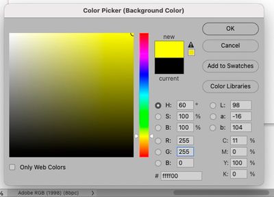

@P38942367gj62 Check this out, in Adobe RGB a bright yellow R,G,B = 255,255,0 is L,a,b + 98, -16, 104
Plainly with L = 50 on the same hue angle (a,b = -16, 105)(see below) it's not a yellow at all but olive green
does that help you understand?

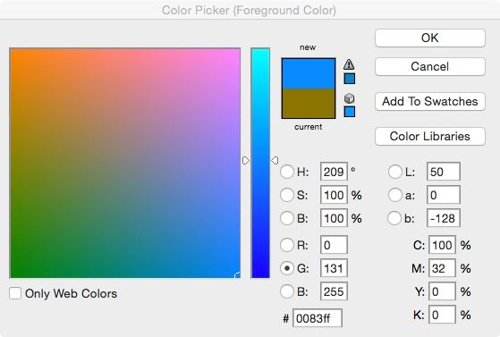

Aug 01, 2024 Aug 01, 2024
mode set to Lab.
Blue token in Lab
Yellow token when set like the blue token at L=50
Yellow token at L=100 "works"
Can someone get a yellow on their setup with L=50?

Explorer ,
When I enter L=50, 0. -128 in Lab mode,
which is the DEFINITION of blue in Lab
photoshop produces  a nice blue color.
The same for red and green.
when I enter the Lab DEFINITION for yellow
L=50, 0 127
photoshop produces a brown not a yellow.
I discovered L=100 which is not a correct value does.
can anyone produce a correct Lab yellow with L=50, 0 127 ?
