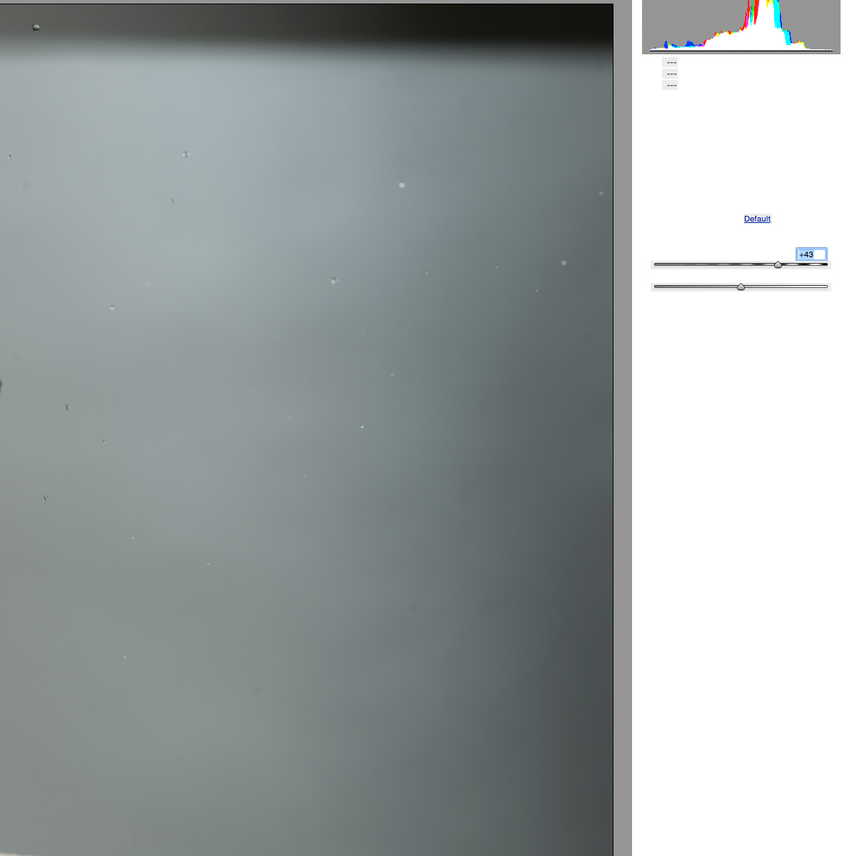

Large black (or white) box on top of the image in Photoshop (does not save to the file)
New Here ,
May 02, 2015 May 02, 2015
Copy link to clipboard
Copied
This has suddenly started - a black box (some times white )
appears over the top of the image & obscures what Im doing. Its not present when I save the file - only when Im trying to work on it. I cant see what Im doing to the image
Help !!
James
Views
57.2K
Contributor , Jun 03, 2015 Jun 03, 2015
To anyone having issues with the Black and White squares, launch Bridge and go to Camera Raw Preferences and at the bottom of the window make sure that "use graphic processor" is UNCHECKED.

I am still experiencing this issue but I think I may have isolated the circumstances under which it happens.
I am running Windows 7 64 bit (all my drivers are up to date) and use Camera Raw (V9.0) to make adjustments to my raw files before handing them through to PS. Once in PS everything seems ok regarding zooming – no white squares.
But if I then go back into Camera Raw FROM WITHIN PS (Filter > Camera Raw Filter) and make any adjustments in the Basic panel e.g. adjust clarity and then return to PS the white squares appear  when zooming (usually at 66.6% and above).
Camera Raw 9.0 uses GPU acceleration (introduced I believe at the last CC update which is when my problems started) so I tried unchecking “Use Graphics Processor” in the Camera Raw preferences. After I did that I repeated going back into Camera Raw from within PS, made some adjustments in the Basic panel and handed back to PS. This time the white squares did not appear. If I then checked “Use Graphics Processor” and repeated the above using the same image file the white squares appeared when using the zoom tool.
So, for me, the issue seems to only occur if I go back into Camera Raw (with “Use Graphics Processor” checked) from within PS and make adjustments using the Basic panel. If I make adjustments in any other adjustment panel in Camera Raw – say add a vignette then the white squares do not appear back in PS if I use the zoom tool.
With “Use Graphics Processor” checked I get the problems, having it unchecked and I cannot get the white squares to appear.
I have run through the above scenario on several different image files and the results are the same – with “Use Graphics Processor” checked in Camera Raw the white squares appear if I go back into Camera Raw from within PS, unchecked and they do not. So, unchecking “Use Graphics Processor” sems to be the answer.
If anyone else experiencing this issue could check out my findings that would be great – maybe my findings will help Adobe identify why this is happening and how to fix it.
