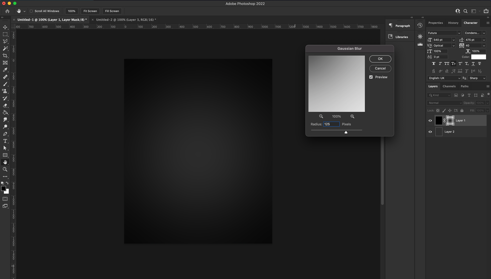

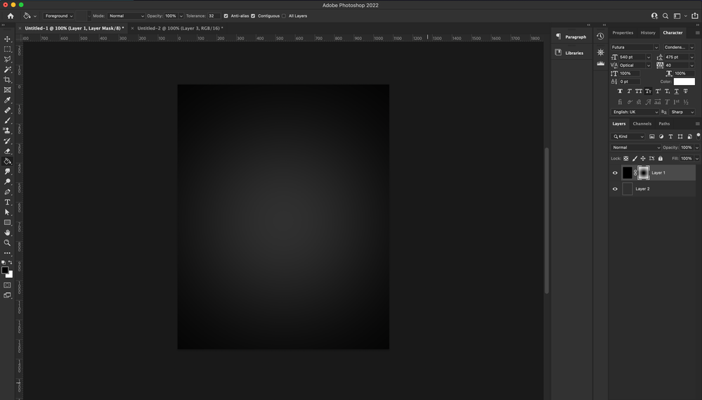

I tried utilizing the Gaussian blur effect, but the more I increse the intesity, the more ring begins to develop. When I adjust it like you've done in the example provided, the lines are not smoothing out. The higher I go, the blend does not smooth out, it does as the pictures show it does.Screen Shot 2021-12-31 at 4.30.40 PM.pngScreen Shot 2021-12-31 at 4.31.05 PM.pngScreen Shot 2021-12-31 at 4.31.27 PM.pngScreen Shot 2021-12-31 at 4.31.38 PM.png

It looks like banding.
Work in 16 bits/channel to avoid banding in the image file. Note- you may still see some banding on screen if you do not have a 30 bit (10 bits/channel) monitor chain.
If you must work in 8 bit add a little noise which will hide the banding.

Jan 01, 2022 Jan 01, 2022
Think of two ladders of exactly the same length.
One has 5 steps, the other 12. Or 250. But they're both equally long.
Dave is spot on, this is banding in an 8 bit display pipeline. As long as the file is 16 bit depth, it's in the display sytem, not in the data.
