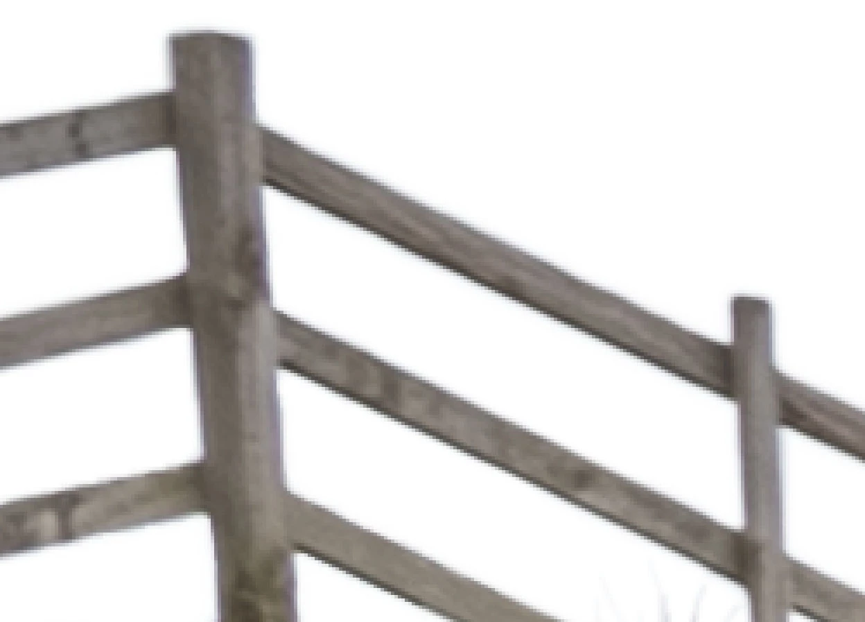

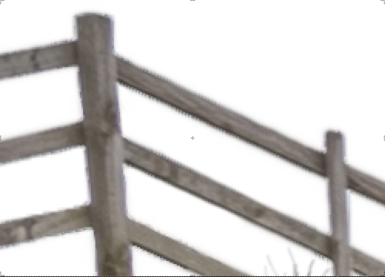

I have a selection made by hand using the brush tool in Quick Mask Mode. I used a small bush size, about 5 pixels in diameter.
When I copy the selection and paste it as a new layer over a different background, there is a white fringe, about a pixel or so wide.
This is to be expected because of the way the selection was made.
However, when I try to remove the fringe using Layer->Matting->Defringe with a 1 pixel width, I get some strange looking artifacts.
They appear as vertical streaks a few pixels in height.
Here is a small section of the image before defringe (over a plain white background)
Here is the image after a 1 pixel defringe
Can anyone explain what might be going on here?

barbara_a7746676
December 19, 2016
The way defringe operates is that it looks inside the pixels along the edges. Then it pushes out those edge pixels to cover up the white fringe. That is why defringe is good for a small amount of fringe along the edge. If the fringe is large, the results can look rather strange.
