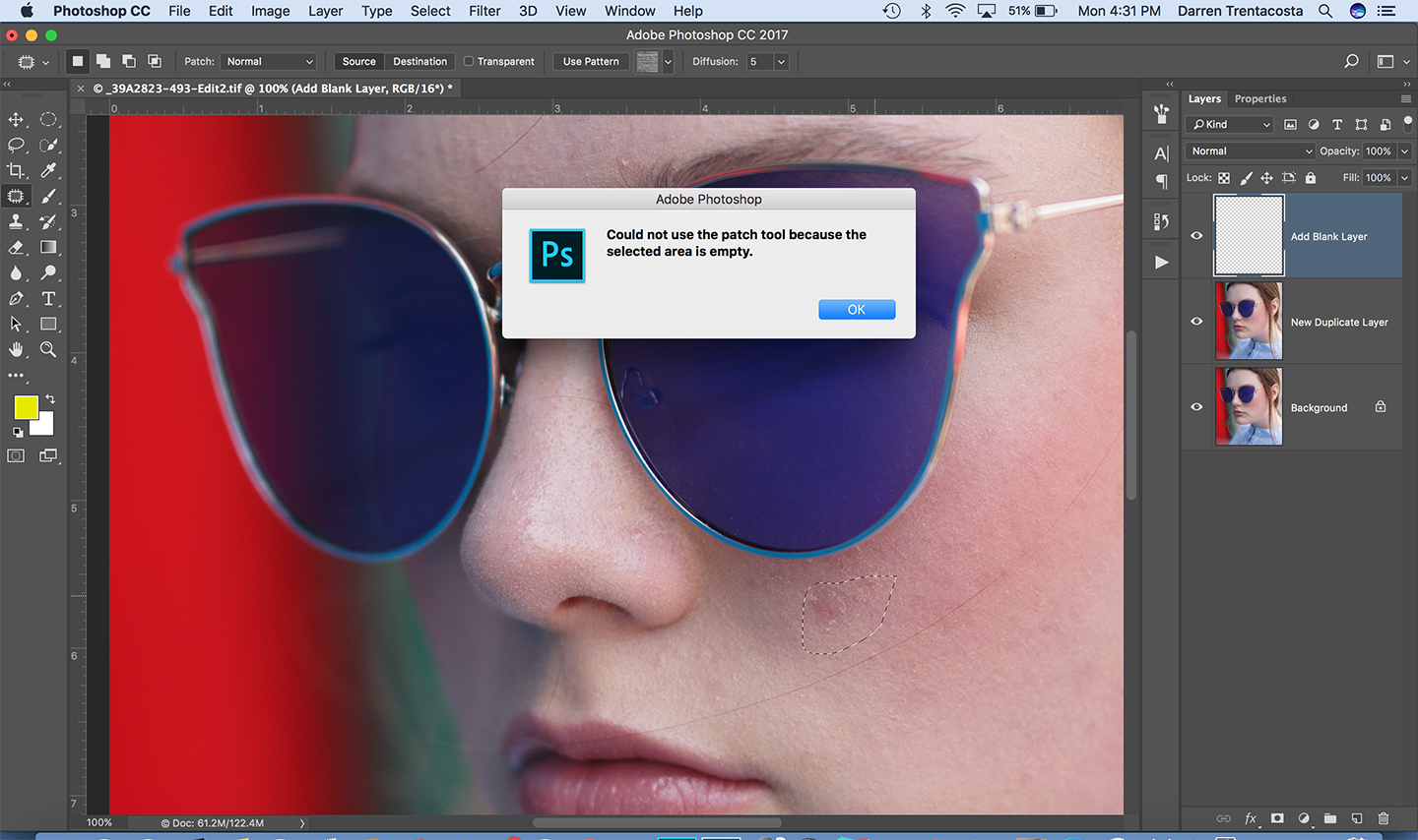

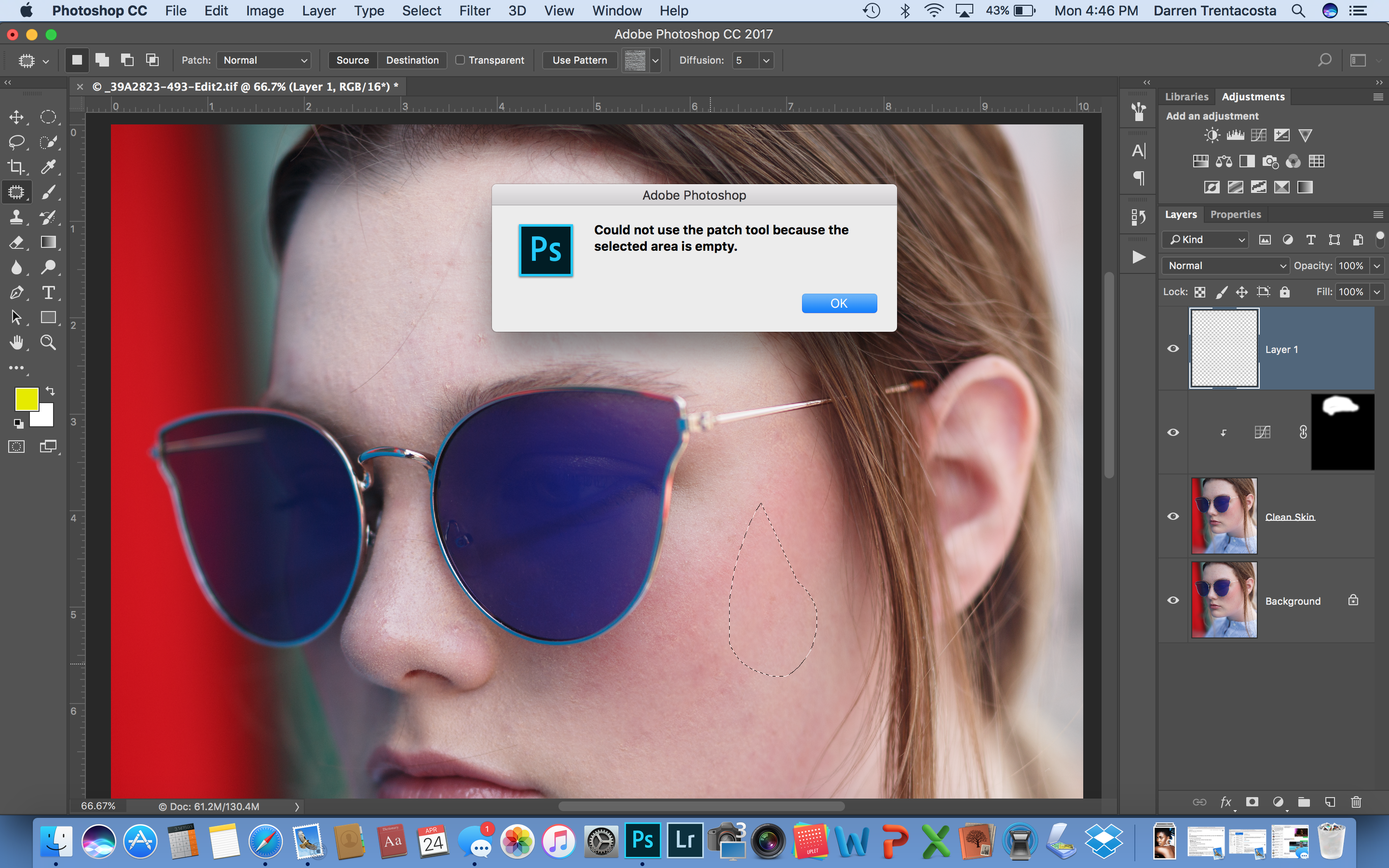

    The patch tool can be used on an empty layer, at least in CS6. Set it to Content Aware and Sample All Layers.
    April 25, 2017
    Thanks, trying now!

    As shown below, it seems the only way I can use all the tools I use (Liquify, Spot Healing, and Stamp) is by creating new Layers from the previous layer below it.  Above you can see I'm stuck two ways...one is that I can add a new Command J from Skin Tone below...b/c its not a top layer anymore, an adjustment layer, that is clipped to it is now on top.  And I not able to go back to the previous Layers (Skin, Liquify, Skin Tone) and make adjustments...as it doesn't allow me to do so...what to do?  I want to continue moving up the Layers ladder...adding more layers

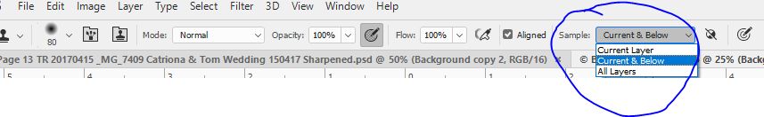

    Another thing to consider, beyond masking, is to use the tools on BLANK layers.
    One of the reasons you're seeing that you can't delete part of what you did on prior layers is that they're duplicates of each other, essentially. Like an Escher mirror painting, each layer contains all of the previous layer.
    Instead, if you're using, say... the  Healing Brush on eyes, do it on a blank layer - make sure that your Control Bar (top of the screen) says Sample All Layers, and then just paint on your blank layer. Maybe this example will help:

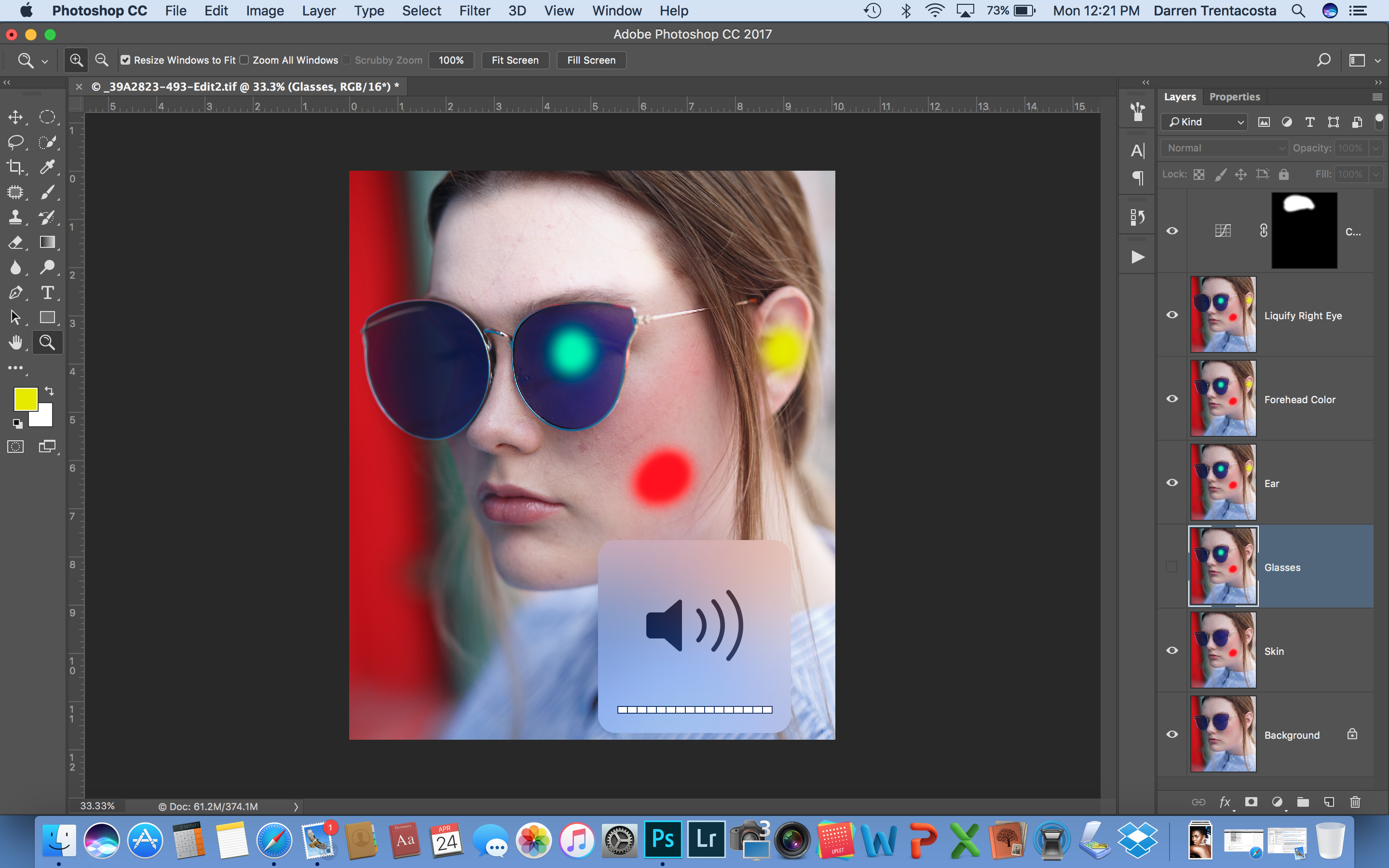

    See the issue for me comes in here...where can I add a new layer with all those adjustments at the top...and assume that a new layer may also have adjustments.

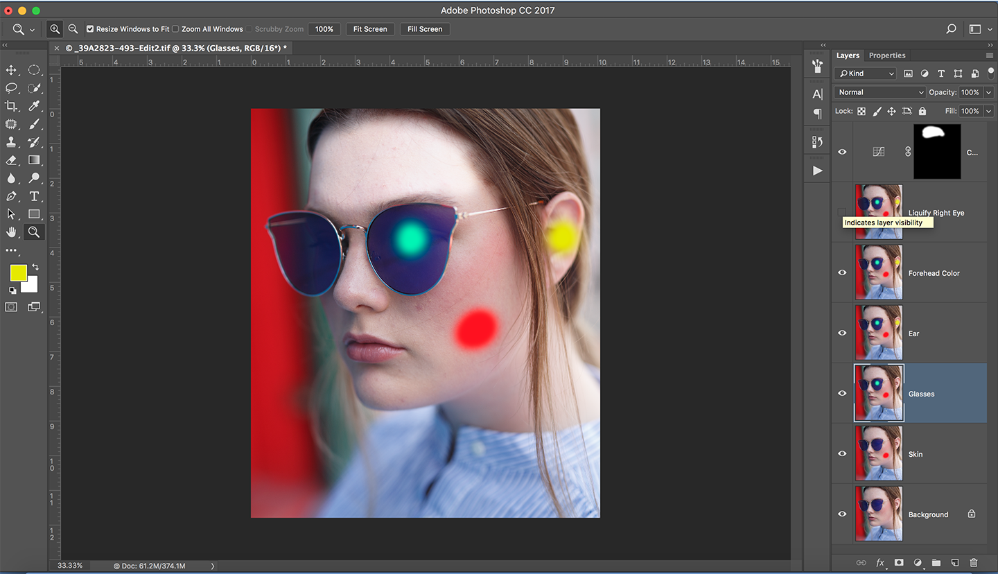

    Here we go...I have exaggerated the above for effect here so you can see it easily.
    If I were retouching, and wanted to make sure I can go back to any layer later on and readjust or delete, you can see here I can't.
    First photo shows multiple layers and an adjustment.
    2nd shows me pretending to "turn off" a layer (hide the green on glasses) but it remains there...so it says to me I'm stuck with the work I did on that layer, cant be deleted or removed.
    3rd layer, however, shows that the top layer, the liquify layer, can be "turned off" (went back to normal size), assuming b/c it sits at the top.
    How do I create a workflow of layers and adjustments that lets me edit or delete what I've done?
