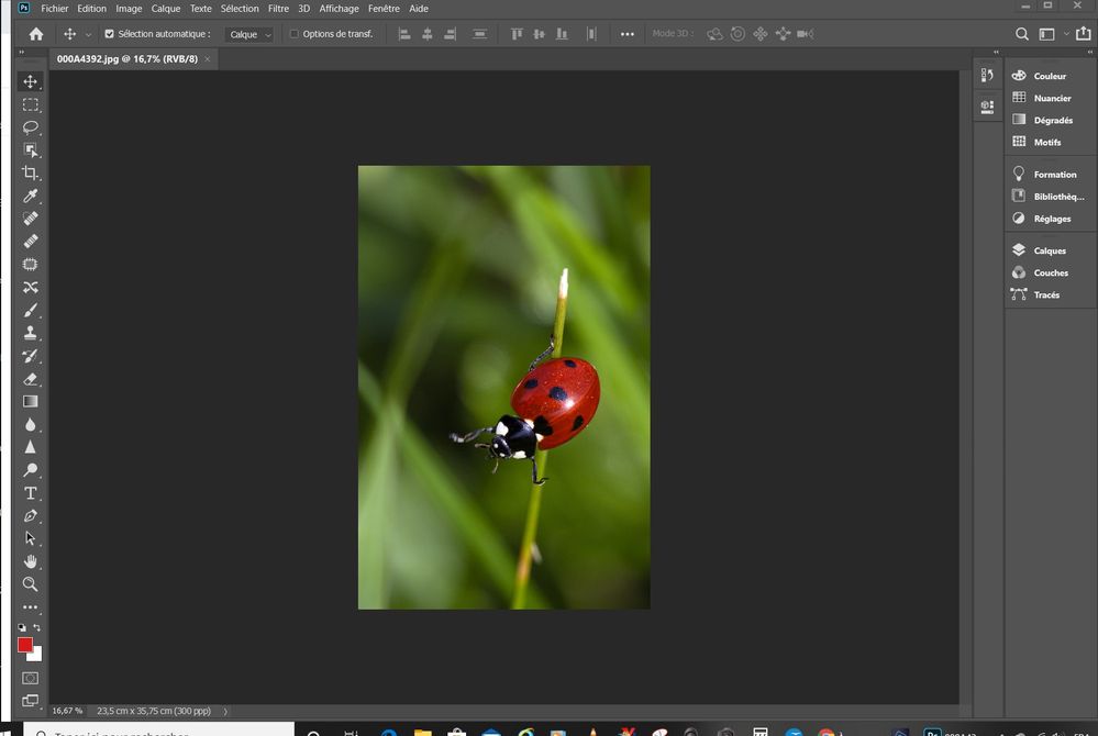

Could you please post a screenshot with the pertinent Panels (Toolbar, Layers, Channels, Options Bar, …) visible?
What are the Photoshop Preferences > Performance > Graphics Processor Settings?

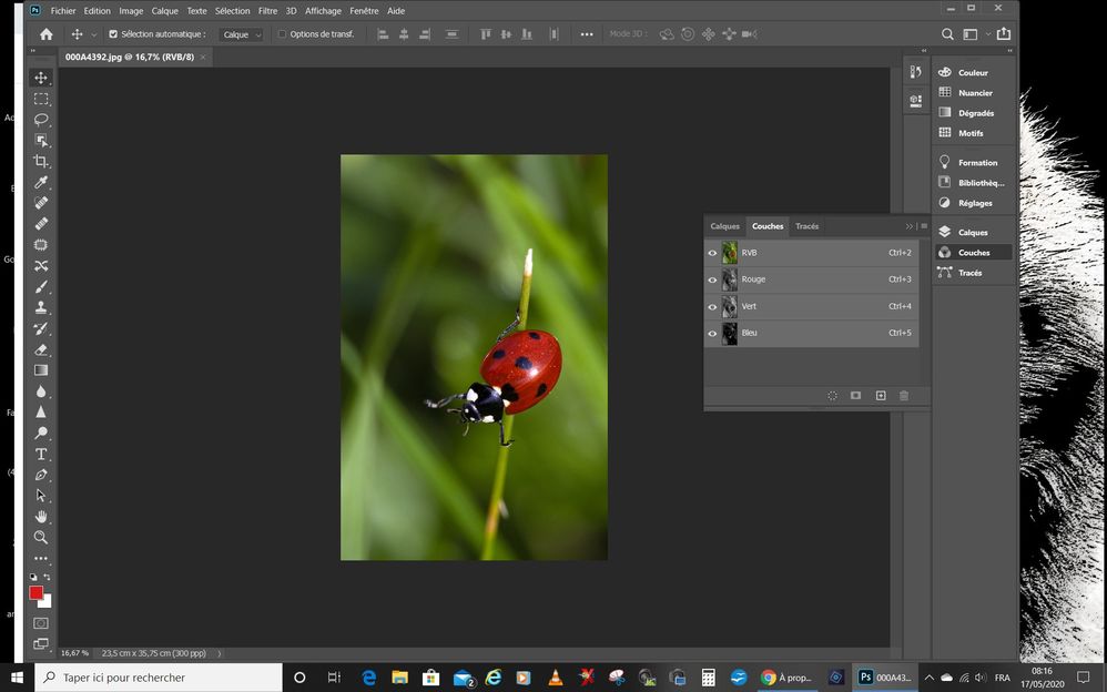

photoshop  coucches.jpegphotoshop 20 filtre .jpegphotoshop barre d'outil.jpegphotoshop performance.jpeg

I miss the Layers Panel.
Have you restored Preferences yet?
Have you tried changing the Advanced GPU Settings (»Parametres avances«) to Basic (and restarting Photoshop)?
