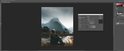

Could you please post a screenshot with the layers panel expanded and visible? Select the layer with levels in the Layers panel, then take a screenshot of the entire window and paste or upload it here.
New Here ,
Aug 19, 2024 Aug 19, 2024
Attaching screenshot and screen recording

that's Blend-If, not levels. Your level controls are right above your Layers...
New Here ,
Aug 20, 2024 Aug 20, 2024
ah sorry my wording was wrong - I need to adjust the Blend if layers but the changes do not reflect - based on the screen recoriding, do you have any ideas why this doesnt reflect?

Attaching screen recoridng with image view at > 100% - still the same issue
All appears to be normal in your video clip.
Your video shows a levels adjustment with no change in the adjustment controls. Then you use Blend If to control which lightness range is being impacted by that unchanged levels adjustment layer. But without a change in the actual levels controls (in Properties) there is of course no visible impact.

holy crap- thank you. i was watching a yt tutorial and i didnt catch that op was only able to change the blend if because they had changed the levels. I thought you would need to jump right to the Blend If part
