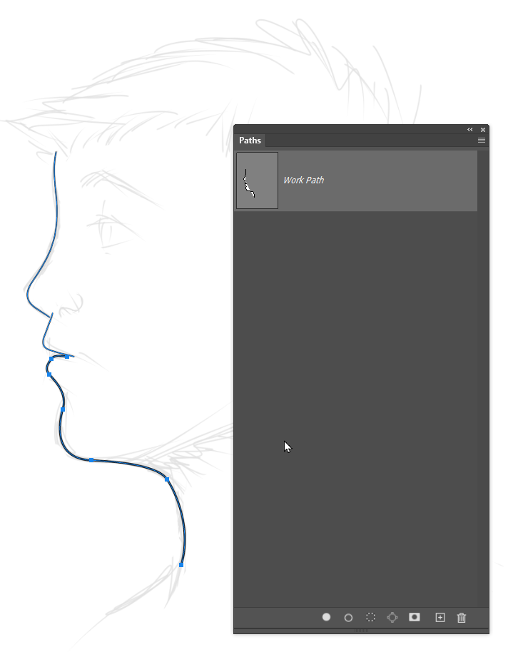

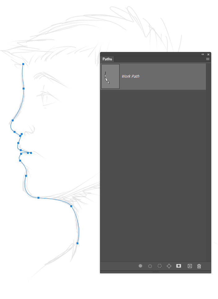

A lot of digital artists and illustrators used stroke paths for critical line work.  Thery make a rough sketch, and follow the line with the pen tool.  Then, after carefully editing the path, just as you describe, they stroke the path with a hard round brush preset
If you check Simulate Pressure, and use a brush preset that has Size jitter set to Pressure, you can stroke the path so that it tappers at each end

I think I more or less understood, but I shamefully jumped in and answered before 'fully' reading your post.  My advice about using stroked workpaths to get highly controlled linework stands, and is something you could usefully add to your Photoshop Tips & Tricks box in a corner of your mind.  It really is an incredibly useful tool.

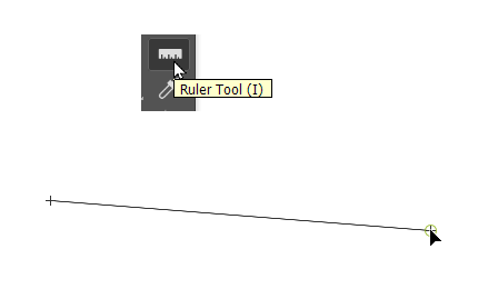

You might have beeen thinking of the Ruler tool regards moving one end of the line, because the Line tool doesn't do that straight off the bat, so to speak.  Having created a line, you can move it without changing length or angle by holding down Ctrl.  To what you asked about you need to enter Free Transform (Ctrl T).
You don't need a modifier key to move one end of the ruler line. just click and drag the cross hairs
