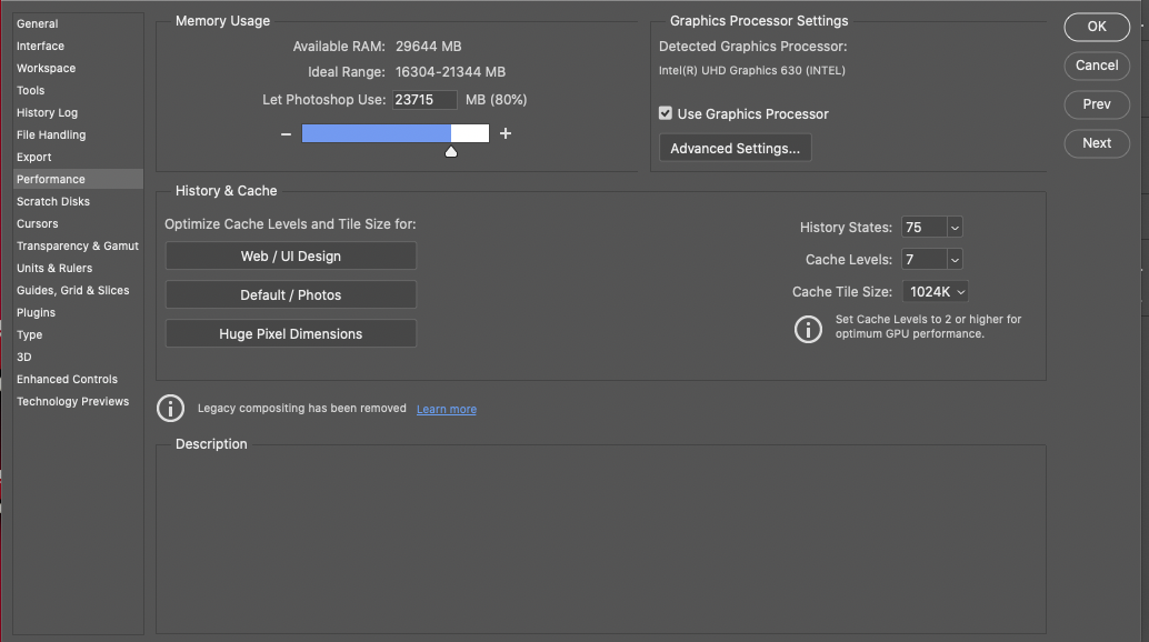

I can see what tutorial (from texturelabs) you have been follownig, which is good because it helps me understand the most likely layer structure you have. If you have something that changes with zooming I would guess that it has to do with your GPU, and that your file is OK. If you flatten your image, just to see if it is a zooming issue or if it is renedering blendmodes that causes this.
What is your hardware configuration? Are you on a mac with M1 (this is not fully supported yet). You should be able to dissable the GPU to see if this is where the fault is. I do understand that you normally would want GPU enabled, but the reason you can turn it off is that it is still that turning it of may give you a more precise rendering even if having it enabled makes Photoshop faster/more responsive.

I tried unchecking the GPU but this had no effect. Flattening the image did the trick though. So do you think it's a setting somewhere in my preferences?

It's possible I guess, but I've not seen that sort of artefact from video card glitches.
They usually take the form of large blocks of white or black, or scattered small blocks of colour, or horizontal noise.
As c.p. has said, we need to see a full res screen shot of your image and layer structure, and a link to this tutorial might help.  We also need to know what Photoshop version and operating system you are using.
Apr 26, 2021 Apr 26, 2021
I suspect this is layer compositing. No, the initial problems with the new layer compositing engine are apparently not quite fixed yet, and they removed the "legacy compositing" checkbox in preferences too soon.
Can you pinpoint the exact layers causing problems - what type of layers are they? Just turn off layers one by one, and see what happens.
What happens if you flatten the image?
If it is layer compositing, this needs to be reported on the feedback site as a bona fide bug.

I did find the layer now who caused the problem but still donlt know why. High Pass is the problem!!! I just recreated the whole file and tried to see when the problem occured. I made a screencast from the file setup and where the problem is. It's in the attachment. I hope it's clear enough as I had to convert it because it was again too large.
