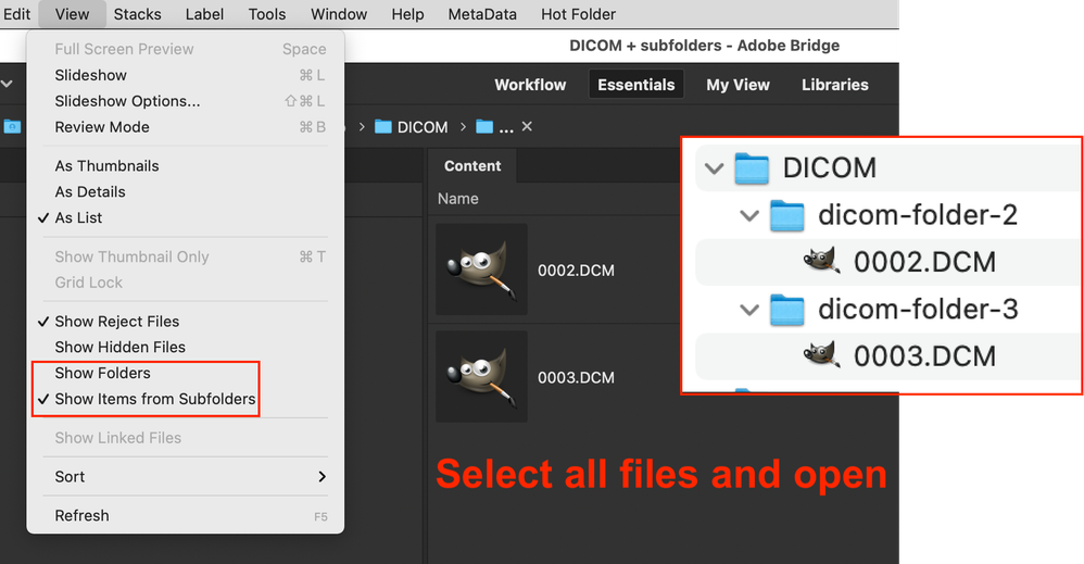

One option to help semi-automate the task is to use Bridge to show all items from subfolders, then hide the folders and possibly use the filter panel to only show .dcm files. Then you can select all files and open in Photoshop. The DICOM interface will then list all the files and you can then use the button to select all images.
