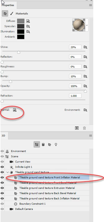

    There are many ways to to that one of which is to use Photoshops 3D.
    1. Use the image with Filter >3D > Generate normal map and save the resulting map
    2. Take an image of sand and make a 3D extrusion
    3. In the properties panel for front extrusion material, click on normal  then Load Texture. Load the map you made above
    4. Adjust the light and render the 3D layer

    Dave, thanks for the tutorial however I'm REALLY struggling to get this to work. I don't see where I can save "the resulting map" nor load it. Any chance you could screen record this?
    davescm
    June 14, 2022
    Unfortunately 3D has been deprecated in Photoshop since I replied in 2018, and no longer works in the new versions. I would now use a separate 3D application and use the logo as a height-map
    Dave
