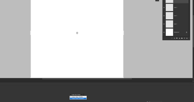

I am running the latest version of Adobe Photoshop 2023 on Monterey.
In the Timeline window > menu  I no longer have the option to make frames from layers. How do I fix this?

Make sure you are on Frame animation not Timeline animation first.

Can you confirm you have multiple layers available and you're not in video animation mode?
A screenshot would be helpful!
Jan 10, 2023 Jan 10, 2023
In the middle of the Timeline panel click the dropdown and select Create Frame Animation, click on the words Create Frame Animation, then you should see the option to Make Frames from Layers.

I'm on the brand new Photoshop 2024 and also have no Make Frame From Layers in my hamburger menu, nor do I have any way of putting any frames into the timeline. I have the 6 images as layers but can't do anything with them.
Any ideas?

I am on the latest PS 2024 and it's definitely there
but you obviously need to create a frame animation first (choose frame animation in the dropdown menu and THEN click on the "create frame animation" button
this is what happens when I choose "create frames from layers"
you can clearly see that all my layers have been turned into frames (compare with the previous screenshot when I didn't choose "create frames from layers" first.)

Your post already helped me... I was selecting "Create Frame Animation" but wasn't clicking that button. Once I clicked the actual button, it worked just fine. THANK YOU!.
