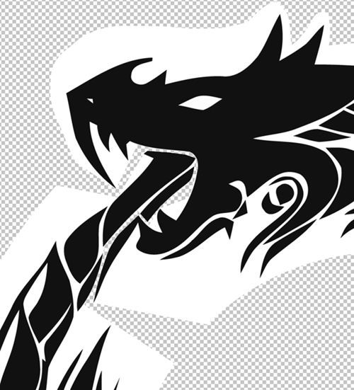

The tricky part is that you have to make enough of a gap so that Puppet Warp doesn't interpret the shape as a circle. Here's what my initial selection (that didn't work) that went between the tail and the mouth looked like:

When I removed more of the tail to create a bigger gap, then Puppet Warp applied along the curved shape:
Then, using Puppet Warp, you place pins along the mesh to control the placement of the mesh. I started by placing the first pin on the neck and added pins about ever large scale or so.
I'd recommend starting from the pin in the tail. Move it slightly outward to the left. Then select the next pin closest to it and drag it slightly to the left and down. Continue shifting the pins to unfurl the shape. You can move the pins a greater distance, but you may wind up distorting the content.

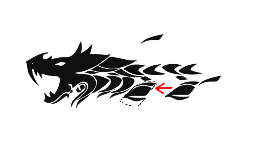

Here is one way:
-Duplicate the layer to retain the original
-Select the head area and go Select>Inverse and Edit>Cut
-Bring up the dupe and duplicate it too, always keeping an untouched original version. Select around various elements and move them over:     --- (edit typo)
-I turned some of them upside down and made some of my own elements to keep the shape flowing

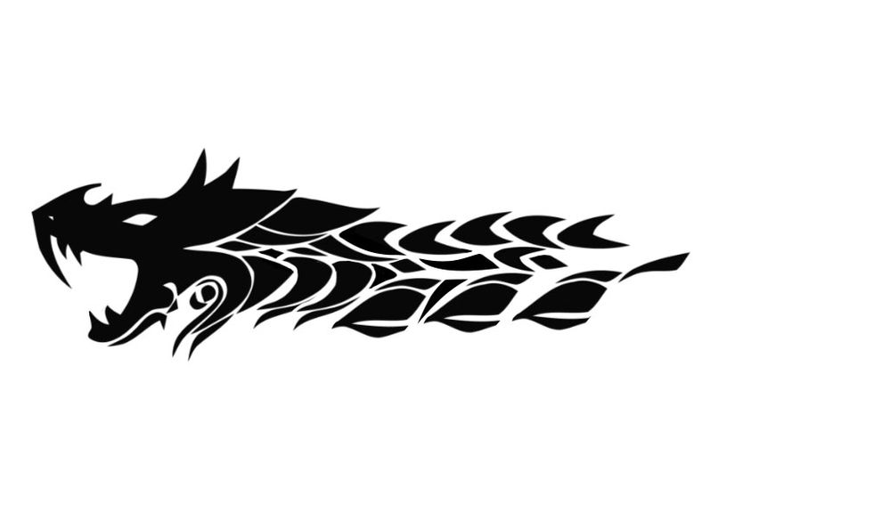

You can straighten it out using Puppet Warp (Edit > Puppet Warp). It's not an automatic process, and may require a few passes to get it where you want.
Here's what I got after 3 applications of Puppet Warp (you may want to spend more time to make it straighter-this was just for a proof of concept):
To make Puppet Warp work on a circular image, I made a selection inside and outside the dragon and another one that created a gap between the mouth and tail. Without the gap, Puppet Warp gets applied to it as a circle.
Once it's in the shape of a backwards C, then you can apply Puppet Warp. I added a pin behind the head and in small segments that let me "unwind" it. The first pass made it a little curved. You can accept the application and apply it again as needed.
