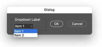

In the previous case, I already knew how to test the radio button (or checkbox) state in order to call a function to "do something".
The next area where I am working things out blindly is testing for a dropdown array... I settled on comparing that the content of the dropdown was equal to itself. The following code seems to work as expected:
// DIALOG
var dialog = new Window("dialog");
dialog.text = "Dialog";
dialog.orientation = "row";
dialog.alignChildren = ["center", "top"];
dialog.spacing = 10;
dialog.margins = 16;
// DROPDOWNPANEL
var dropdownPanel = dialog.add("panel", undefined, undefined, {
dropdownPanel.text = "Dropdown Label";
dropdownPanel.orientation = "column";
dropdownPanel.alignChildren = ["left", "top"];
dropdownPanel.spacing = 10;
dropdownPanel.margins = 10;
var dropdownMenu_array = ["Item 1", "Item 2"];
var dropdownMenu = dropdownPanel.add("dropdownlist", undefined, undefined, {
    items: dropdownMenu_array
dropdownMenu.selection = 0;
// OK & CANCEL BUTTONS
var okButton = dialog.add("button", undefined, undefined, {
okButton.text = "OK";
okButton.alignment = ["center", "center"];
var cancelButton = dialog.add("button", undefined, undefined, {
cancelButton.text = "Cancel";
cancelButton.alignment = ["center", "center"];
// WRAP THE UI ELEMENTS INTO A FUNCTION
function buttonActions() {
    // DROPDOWN SELECTION TESTS
    if (dropdownMenu.selection.text === "Item 1") {
        // CALL THE FUNCTION
        dropdownItem1result();
    if (dropdownMenu.selection.text === "Item 2") {
        dropdownItem2result();
    // DROPDOWN FUNCTIONS
    function dropdownItem1result() {
        alert("You selected Item 1");
    function dropdownItem2result() {
        alert("You selected Item 2");
// SHOW THE WINDOW & CALL THE DROPDOWN FUNCTION ON OK, OR CANCEL THE SCRIPT
// dialog.show() - 2 ? buttonActions() : alert("Script cancelled!");
dialog.show() - 2 ? buttonActions() : undefined;
I presume that an alternative method to determine which dropdown menu item was selected would be to use a test for the array item index number? If so, I can't figure that alternative method out though.
And I'm guessing that testing other GUI elements will present their own challenges. What does editText use? What about sliders? This is why I'm struggling to find documentation and easy to understand samples. Building the scriptUI is simple as the tool from Joonas does all the hard work, but getting the interface elements to "do something" is now my challenge.

Jun 25, 2021 Jun 25, 2021
I hate to admit defeat, however, I just cant work out how to access the array index, or another method.
This snippet works to run a function based on the selected dropdown array item:
These variations don't work:
(dropdownMenu.selection.text[0])
(dropdownMenu.selection[0])
(dropdownMenu[0])
(dropdownMenu_array.selection.text[0])
I'm sure that the answer is obvious to those in the know, but very frustrating for me. It took me hours to figure out how to do this the first time, I'm just looking to learn other ways, by index or any other workable method so that I can explore the pros/cons.
LEGEND ,
dropdownMenu.selection.index
Thank you, but I have tried that and other variations before, I didn't list all of the useless code attempts that I have made, that was just a short list! More non-functioning examples below...
if (dropdownMenu.selection.index) {
/* The previous code is obviously incomplete, so let me try something else */
if (dropdownMenu.selection.index[0]) {
if (dropdownMenu.selection.index[1]) {
/* The above doesn't work, so let me try something else */
if (dropdownMenu.selection === index[0]) {
if (dropdownMenu.selection === index[1]) {
/* The above is useless, so let me try something else */
if (dropdownMenu.selection.index[0] === true) {
if (dropdownMenu.selection.index[1]) === true {
I have read countless tutorials and code examples. I'm obviously missing something simple. This is why I pasted full code earlier in the topic, out of context code isn't working for me.
I'm sorry for asking the forum again, I did ask previously but there was no reply. Isn't there a repository that lists this sort of stuff with simple working code examples? The tool from joonas is great in building a GUI, but there is a disconnect between having a GUI and making the GUI actually do something.
LEGEND ,
eval('dropdownItem' + (dropdownMenu.selection.index + 1) + 'result()')
Explorer ,
I'd stay clear of "eval", as it's about as insecure as it gets and generally not nessecary..
the above code should really be:
theFunc = 'dropdownItem' + (dropdownMenu.selection.index + 1) + 'result';
theFunc();
or:
('dropdownItem' + (dropdownMenu.selection.index + 1) + 'result')();
yeah, that actually works..
But, in this instance, what you REALLY want is:
//dropdownmenu code
dropdownmenu.onChange = function(){
 if( this.index >= 1 ){
 } else{
or something similair..
LEGEND ,
If you firmly state 'eval' is insecure, please share some examples...
The two snippets you posted to use instead of eval does not work.
ps. onChange is useful, but the above problem is not about method but the logic.
Explorer ,
The code doesn't work indeed.. weird.. SHOULD work as it is basic JS.. sorry about that, should've tested it..

Thank you for your input. OK, let's reset the topic...
From my perspective, what has been asked is very simple. The answers have not been simple I'm afraid, that is expected. I'm finding scriptUI to be very difficult.
Kukurykus helped me to get the Cancel and OK working as expected (thanks again).
In my second large chunk of code, I have posted 67 lines of fully working code. It is embarrassing how many hours this took to get my first working result to check and run a function for each dropdown item.
I am searching if the text of the selected dropdown item is true. Again, it took me many hours to get this result. It works, but I have to expect that there are other ways of doing the same thing, probably better than what I came up with by trial and error.
The dropdown list has 2 items, it could be 3 or 10 or more. I just wanted to start with the bare minimum and 1 item is not enough to be sure that things actually work.
Looking at isolated code snippets does not help me, I need to see working code in the context of the script to see how it all "fits together". There is a disconnect for me between simple examples such as on the W3C site and getting things to work within a scriptUI and Photoshop environment.
I am also lamenting the fact that there does not appear to be any great working examples of how to make the scriptUI elements "do something", in my case calling a function, a different function for each of the dropdown items.
@Kukurykus
Your hint eventually proved helpful, I had to bash my head against the keyboard too may times until something worked as expected. The problem was with what you didn't put after .index
    if (dropdownMenu.selection.index === 0) {
    if (dropdownMenu.selection.index === 1) {
All of the info regarding returning the selected array indes number that I could find used square brackets around the index number:
.index[0]
.index = [0]
.index == [0]
.index === [0]
This was not the correct syntax for my particular code, I just needed:
.index === 0
