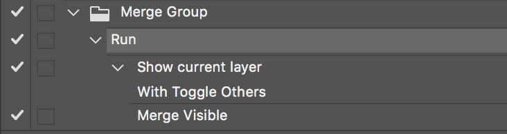

If you are after a fast result, then the following action will get the job done fast for a selected group:
The key step being to hold down the opt/alt key when recording the visibility click on the group layer.
If this is a “simple” exercise to try to learn scripting, then it sounds like a good choice!
