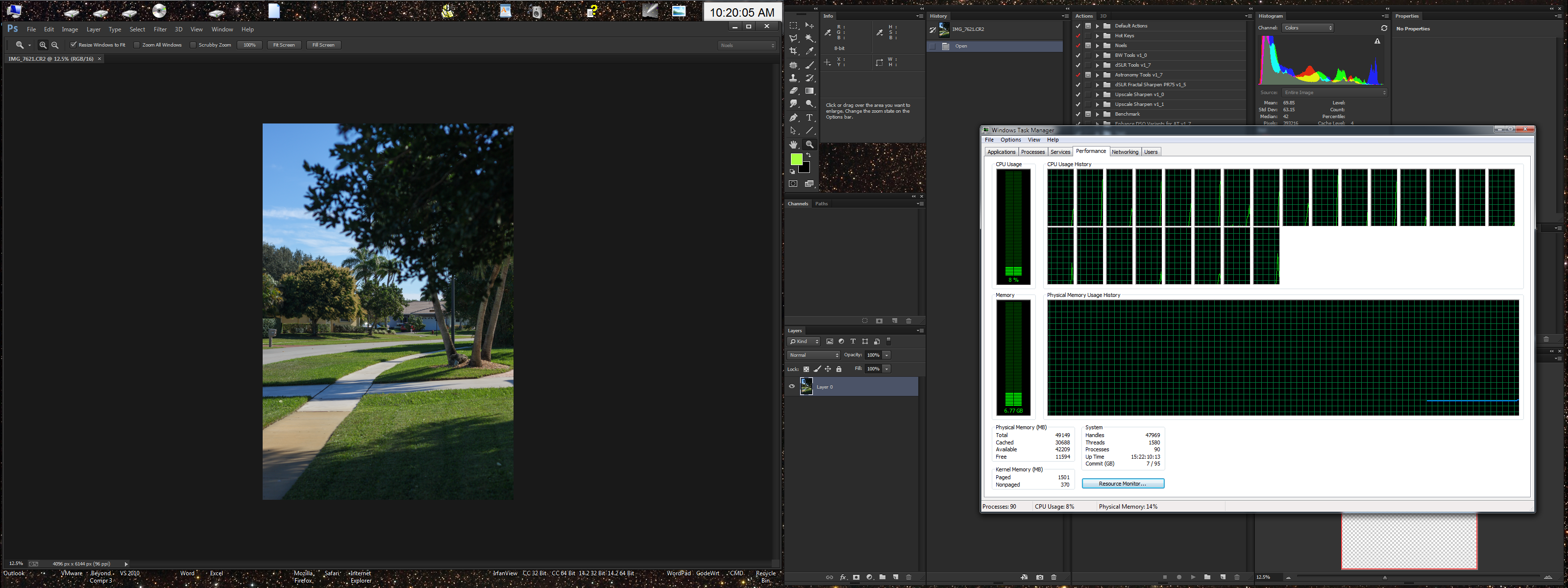

I have 5 images I select to make a panorama.  Usiing PS CC 64 bit on Windows 7 OS, File/Automate/Photomerge works fine.  But when I try to select the photos in LR 5 and Edit in/Merge to Panorama in PS, it opens PS CC and loads the 5 images and opens the Photomerge dialog box as I would expect, but when I click OK it begins the merge process and hangs up and PS stops working.  So I can get "photomerge" to work if I choose the images directly from PS, but not when I send the images to PS from LR.
I've never had a problem with this process with CS 5 or CS6.
Help Please.

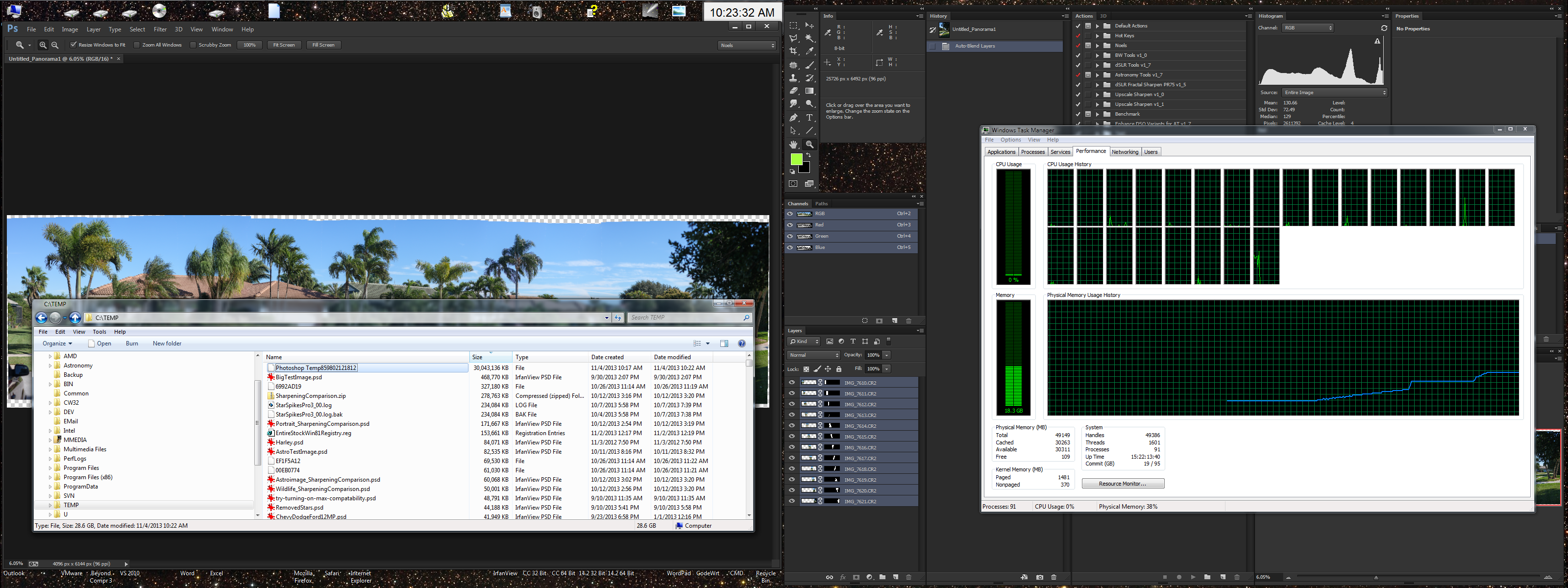

JJ, It's 2pm EDT now. I've allowed access to those photos. See what you can do. From the looks of things, I'm out of luck. If you can pull something off, let me know. I'm going to restrict access in a few hours when I get back home. Too many folks were helping themselves to my photography. Thanks.
Nov 12, 2013 Nov 12, 2013
I downloaded the three images and both CS6 and CC Photomerge stitched them without problem in about 2 or three minuets in auto mode and blend and geometric distortion correction boxes checked used very little CPU and around 2GB of RAM

If it can be at all helpful, here's a sequence of what happens in order, and how long each step takes, in the case where it completes successfully.  Note that the overall operation to stitch 12 raw files opened to 6144 x 4096 x 16 bits/channel took a hair over 3 minutes to complete, and used 18 GB of RAM and 30 GB of scratch space,.
Selecting the files:
Hitting the [OK] button at exactly 10:20:00:
First thing we see in Photoshop at 5 seconds is the first image being opened:
At 47 seconds all images are opened and aligning begins:
At 1:46 Blending commences on the wider canvas:
At 2:45 into the process, it's creating layer masks.
At 2:57 it's creating a seamless composition:
At just over 3 minutes, it's done.  Note especially that RAM usage has risen to 18.3 GB total.
Note also that 30 GB of scratch space was allocated.  This was a fresh run of Photoshop.
-Noel
