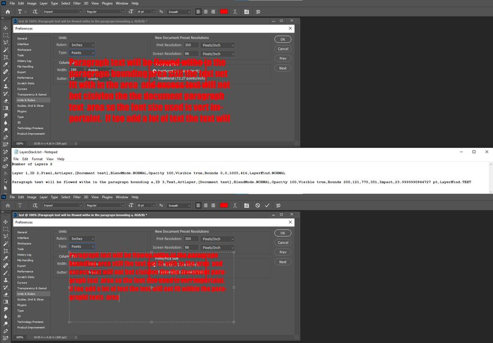

If it is paragraph text the text must fit within the paragraph boundaries. If the text layer is not a Paragraph  text will not flow automatically you will need to add the new line carriage return into the text to flow the text and  position it over the canvas and set the font size  so the text will fit on canvas.  Text is very complex.  Skills above my pay grade is required.  To deal with size  you may need to change the document resolution to 72 for you size calculation  I believe font size is based on points being  72 pixels. Your script seems to add the artlayer makes its a text layer  position it document center and set its content from the dialog.  Size 45 Calibri-Bold.   There is no checking to see if the text  Size 45 Calibri-Bold will fit in the Document. No  document size check no checking of the canvases resolution.  The only constraint I see   may be "edittext", [0,0,500,300], "" but then I do not know ScriptUI  or know if the document canvas bounds is the  Paragraph Bounds.  Text is not something I script.  image.png
Here size 24pt is to large] where 18pt is fine.
JJMack
Dec 30, 2021 Dec 30, 2021
Running you script it look like  the Document canvas size does become the Paragraph bounds and you positing  to the documents center so 3/4 of the paragraph area is off canvas.
Moving the layer more on canvas I see the bounds is not the canvas size perhaps its your dialog edit text areas
0,0 - 500,300 which is still taller than my canvas size
